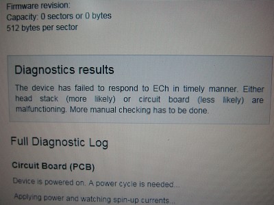

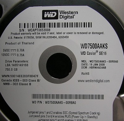

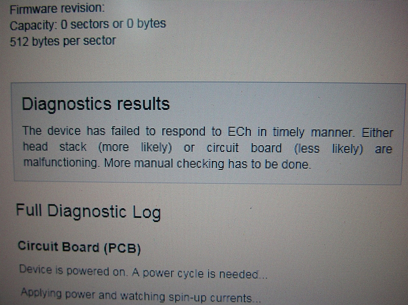

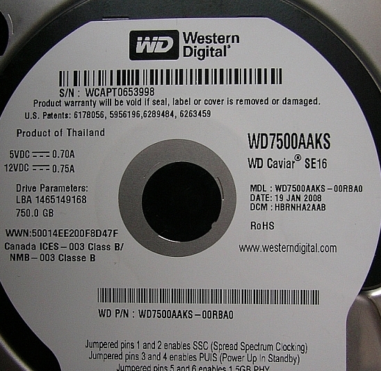

Very little doubt here. But wanted to be sure. Anyone done H/S on these? Tips? I have a cleanbench, no head "combs" but have never done more than a double head. There are 4 platters I think, 8 heads?
Just for fun I included the atola insight diagnosis, pretty right.
One thing I don't get is the two distinct startup sounds. Almost alternate (random) one to the other. AND that the drive was damaged by one of my employess who blew a 80Gb WD at the same time :evil: Thats what makes me think .001% chance PCB.

Hello your Hard Disk presents the same sounds that I have shows only that what I have is 500GB, and presented this problem will probably fall after a head or shaft

While I have not performed a head swap on these series WD drives; I personally own a 640AAKS and did quite a bit of research on them. They are the ~320GB per platter design; and they actually utilize a ramp; so as long as you load the new heads on to the ramp they should be fairly aligned; the ramp should somewhat eleviate the lid screw issue. As long as the heads remain parked on the ramp when you tighten then lid screw the drive should at least be in good enough shape to recoer data; but on the negative side these are high density drives, so in that respect; Godspeed to you.

FAILURE!
well, to be honest, it did not work out :cry:
after a text book head swap (yes all 8 of them) nothing. The H swap went very smoothly, probably the best and cleanest I've done. ESD precautions all way through, cleanbench perfect.
But, disk does same. Maybe one of the lower platters has some damage. Maybe still PCB.
Any ideas. Please ;)
