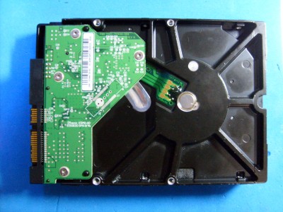

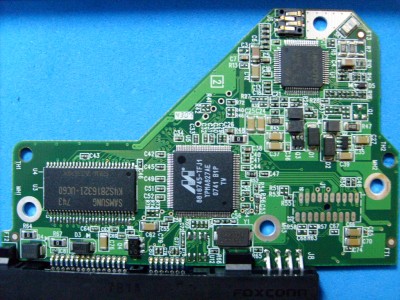

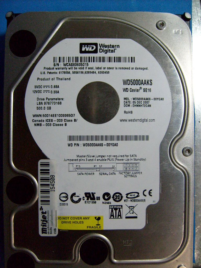

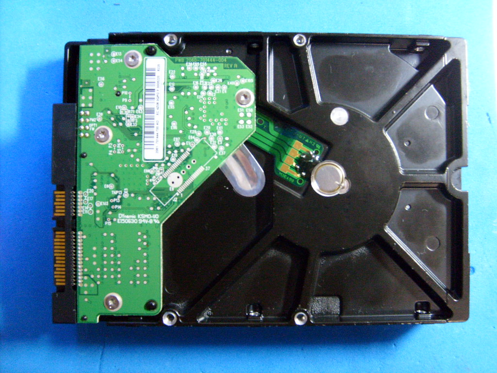

Hello I'm having a problem in a Hard Disk WD, which fell the same was in a Case and running, the league WD click click click after some 30 seconds from now disconnected thank any assistance required
Luiz

It's probably a heads problem. It could also be the PCB. Find a PCB with the same number and reprogram the ROM if you have a PC3000; physically swap it if you don't. If that doesn't work, it's a mechanical (heads) issue and you'll need pro service.

I'm surprised the spindle isn't locked. Every dropped hard drive I've seen lately has a locked spindle.

He was within a Case for Hard Disk fell when the Hard Disk was connected when I fell I have PC3000, I believe in changing the PCB would most like to hear views thanks to all

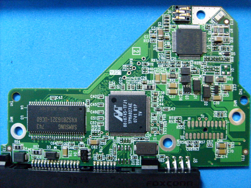

PCB

Sorry -- I overlooked the fact that it fell.
Disregard my advice about the PCB. It's most likely a mechanical issue - heads or spindle.
