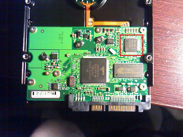

Hello denizens of HDDGURU,
I need your advice on what to do with this seagate hdd. I've searched the forum for some ideas and i think may figure out what to do. I just need extra conformation or a slap in the face for thinking in the wrong direction.
Model : Seagate Barrcuda 7200.10 ST3500830AS
S/N: 9QG1K72S
P/N: 9BJ136-566
Firmware: 3.AFE
Date Code: 07436 Site Code: TK
Made in Thailand
PCB No: 100406540 E 7742UE0U
Symptoms:
- Repetitive soft clicking noise every 2-3 seconds when powered up.
- Not recoqnised by any BIOS
- Marked spot on the PCB get very hot to touch after 20-30 secs powered up.
My guess so far:
- Defective PCB, need replacement.
I've been combing ebay for such replacement but no avail. Contacted dariusale (found from some post) but he can't help me. Googled for replacement part and can't seem to find it.
My questions are:
Am i barking the right tree here? Is it the PCB?
Any suggetions where i can get the PCB replacement?
Any help much appreciated.

I bet it's a frozen spindle bearing. Can you feel it spin up?

High capacity Seagate drives are the worst drives available at the moment. I have dozens of them awaiting platter transplants due to bearing seizure.
I would also guess that you have bearing seizure.

I can feel it vibrating when i fired it up, but i can't be 100% whether its spinning or not.
Your suggestions seem to right on the money. What happened, the sick hdd use to live inside a seagate freeagent pro extrenal hdd. I was copying files into it and i accidentally knocked it. It fell from its upright position to its side. Note: It didn't fell from an elevation, it just tipped. And it was a thickly carpeted surface. SO i assume theres negligible impact. Afterwards, the external hdd wouldn't work at all and made a soft repetitive clicking sound.
I thought it was a faulty power component in the extrenal case. I proceed to extract the hdd and plugged it directly to my comp. No luck. So yes, seized up bearings might account to this.
My next questions are: Would this cause the pcb to heat up after a 20-30 secs? And what can i do to fix this?

It's also possible that the G-Force sensor shut down the motor and left the heads parked on the drive (although it doesn't take much to ruin the bearings, either).
The IC that gets hot is the motor driver. It can't properly dissipate the load into the motor windings if the motor is not turning. This is normal and does not usually indicate a PCB fault.

Exactly. The hot chip makes it easier to diagnose bad bearings. Then again, probably the biggest clue the bearings were bad was that it's a Seagate....
