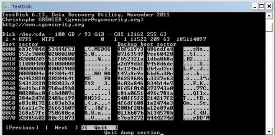

Hi there, hoping you guys can help. Frequent reader, first-time poster. Let me start you off with a brief story:
I'm working on a HDD that (according to the owner) was attacked by a virus causing "Error loading operating system" when trying to boot into Windows XP. I loaded the Windows XP CD-ROM, ran the Recovery Console, ran 'fixmbr' followed by (and I think this caused all of my grief) 'fixboot.' Now, the main partition which was NTFS is appearing as FAT12, with size of 10MB. It looks to me like 'fixboot' has overwritten the NTFS boot sector with a FAT12 boot sector.
Now, my only mission here is to recover data, not to make the drive bootable. I know that in order to view files from the missing partition, a valid boot sector must be intact. I've done 2 days of research, and used many programs (TestDisk, Active Partition Recovery, GetDataBack, Easeus, etc.) but have had no luck rebuilding the boot sector and accessing files. I manually tried to find the backup boot sector, also to no avail.
I'm attaching a screenshot of my boot sector dump, according to TestDisk.
On a side note, how important is changing options such as LBA, CHS, etc for the drive? Could it be that the drive was configured a certain way in the original machine's BIOS and now, in another machine, is not in the correct mode? At this point, I'm really trying to think outside the box.
Thanks!

I have had the same problem, although in my case the original file system was FAT32. My approach was to manually repair the boot sector. The job was made a little harder because the copy in sector 6 was not an exact copy of the original (Windows XP had been installed over an existing Windows 9x installation).
The first thing I have to say is that the Microsoft programmer who is responsible for this evil bit of code is braindead. Since when does replacing a HDD boot sector with a 10MB FAT12 copy constitute a fix?
Now that I've got that out of the way, could you upload a dump of sector 0?
I would also write zeros to the FAT12 boot sector. Its presence will only confuse your data recovery software.

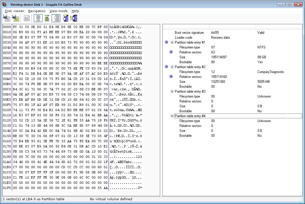

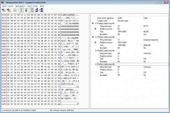

Thanks for the response. Agree with you about the Microsoft programmer. I'll hold him - you punch.
Writing 0's is a great idea - I'll get on that immediately. Attached is sector 0.

 Post subject: Re: Boot Sector Issues
PostPosted: March 15th, 2012, 9:09
Posts: 17389
According to the partition table, the first partition begins at LBA 0x3F (= sector 63). The size of this partition is 0x0B089DF1 (= 185 114 097 sectors). This means that the last sector of the partition (where the backup NTFS boot sector is located) is 185114159.
In my case, FIXBOOT did not touch the backup FAT32 boot sector, so I would expect that in your case it should also have left the backup intact.
