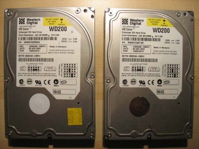

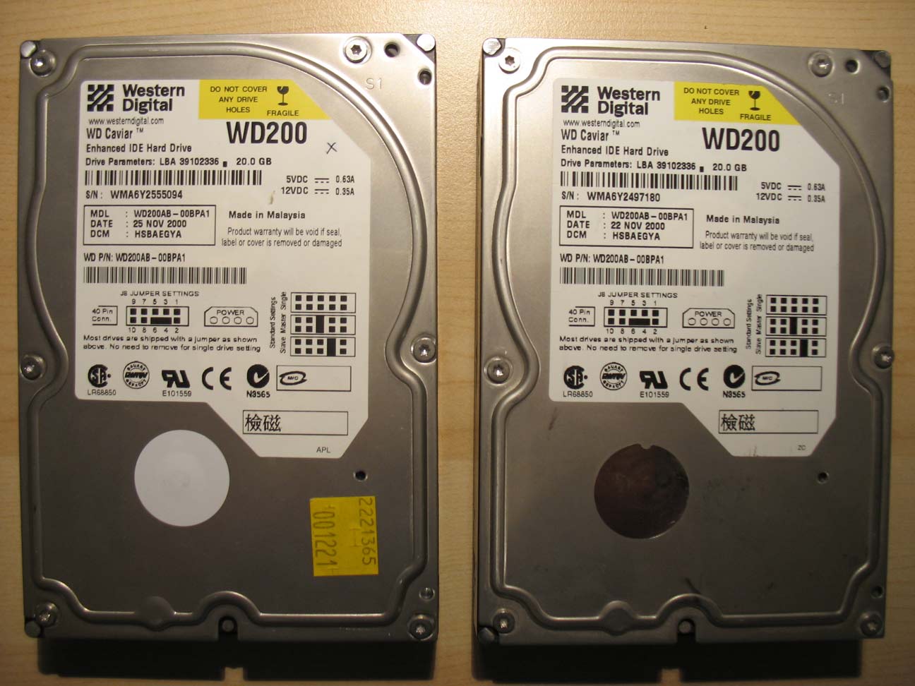

I've tried to find a donor drive as close as possible, and was lucky enough to find one with same model and same DCM, and only 3 days difference:
Model: WD200AB-00BPA1
DCM: HSBAEGYA
Date: 22 nov 2000
Made in: Malaysia
The two drives next to each other (bad on left side):
File comment: Bad drive on left, donor drive on right

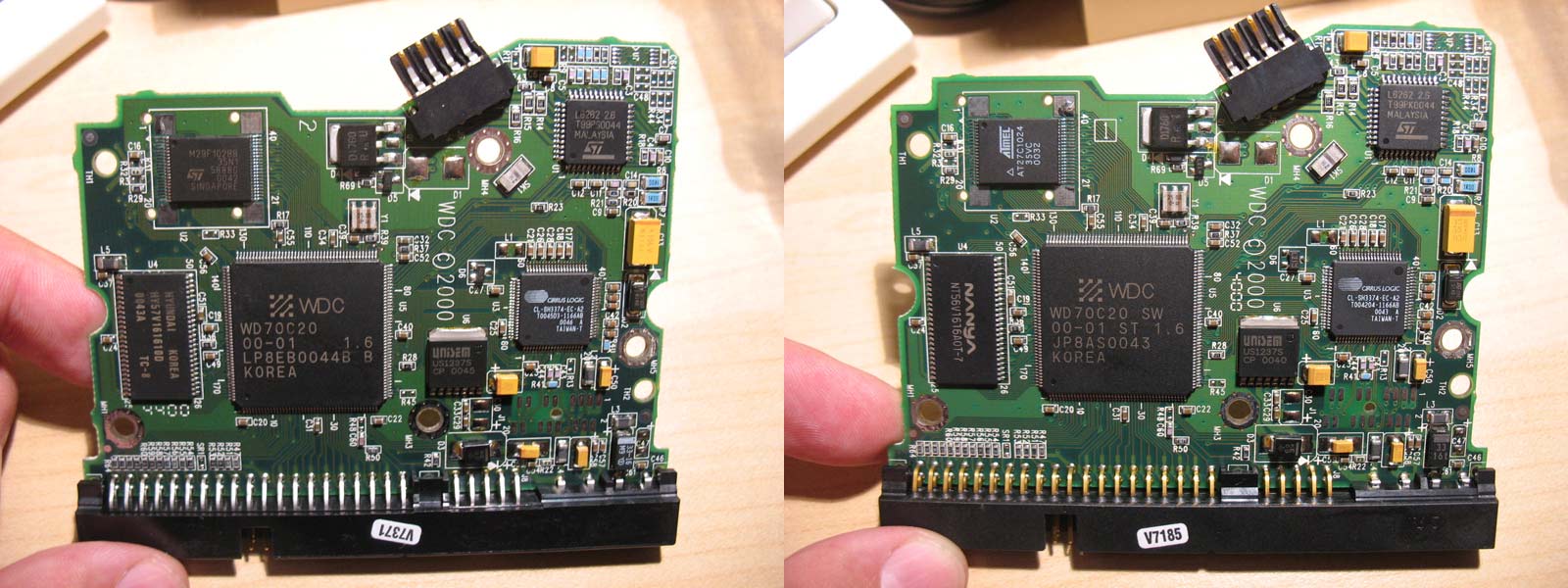

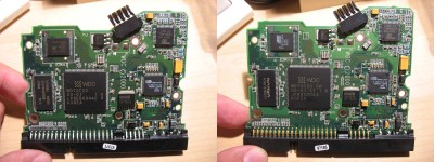

Unfortunately, the PCBs are not the same.
The bad one has the barcode: 0000 001003-001A X W OR17 A2WJ 7 00 66 21 0 1214, and V7371 on the other side.
The good one has the barcode: 0000 001003-000C X W OR13 5YJ9 8 00 66 21 0 1217, and V7185 on the other side.
For the first sight, the main differenes are: Hyundai versus Nanya RAM chip, and Atmel versus ST ROM chip, which seem to be equivalent (at least as far as I can see).
Please note that the PCB photos are taken with swapped ROMs!
File comment: Bad PCB on left, good PCB on right.
ROMs are swapped!
So I swapped PCBs right away, the terrible sound is gone, drive is recognized in BIOS (at least when it's slave), but still cannot access it.

I think that you are close of getting it to work. If you have pc3000 board, you may be able to diagnose the issue fully. Somewhere, there is a firmware issue that prevent you from reading the logical block addressing of the drive. You may try another board, even not close to the exact match that you have. Sometimes, that will work to get the drive going and recover data. These drives are very peculiar in many ways

Different boards can have different power inputs to the preamp that will kill it imediately, so it is not advisable to use such boards.
I could take a look at it if U want.
