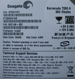

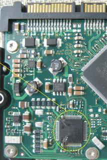

In need of a pcb board for a seagate 500 gb 7200.9. My hard drive touched
the case and fried a chip. If anyone can recommend a temporary fix or has an extra board I would greatly appreciate it.
Seagate Barracuda 7200.9 ST3500641A
S/N: 3PMOJYKY ST3500641A P/N: 9BD148-303 FIRMWARE: 3.AAE DATE CODE: 06406 SITE CODE: AMK

Buy a similar drive with same PCB and replace ROM ic.

thanks, but they are up to 7200.11 they are hard to come by.

try 2nd hand, ebay...
