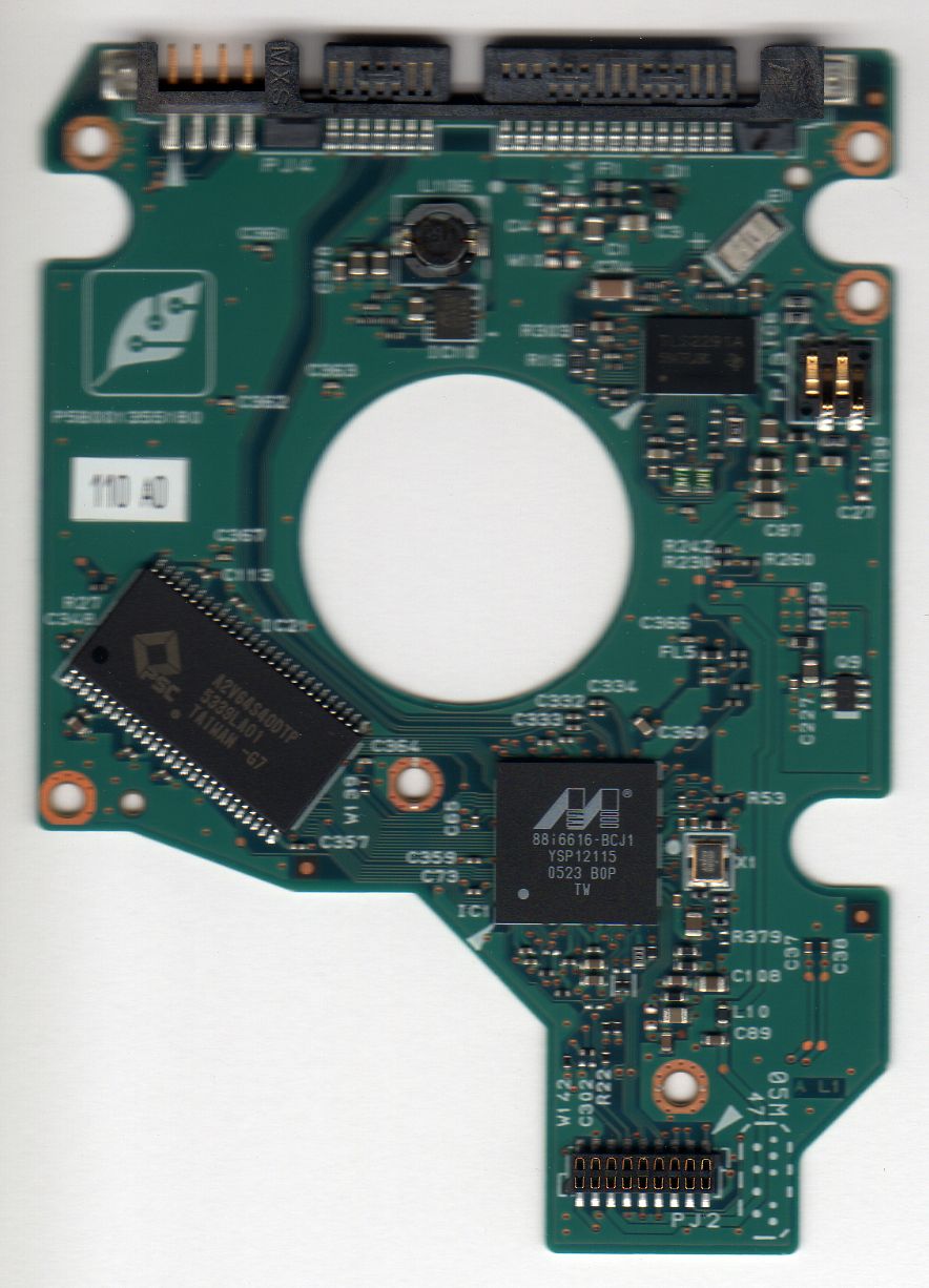

Thanks for the prompt replies! I attached a photo of the PCB. Sorry it is so blurry, my camera is messed up. Will try to get a better photo later if needed.
So it sounds like a PCB swap is out of the question. Apparently the drive was hit with a power surge (the motherboard & LCD of the Sony laptop it was in was also fried) is it possible the PCB is too damaged for DR?

It appears that your board does have an external flash ROM chip. That's good. Apparently,
your original DR guy tried to repair the board, but when that failed he gave up. The fact is a donor PCB with a transfer of the original ROM contents (or the chip itself) will solve the problem (assuming other problems haven't occurred within the drive itself). The critical thing here is that you must have the original board. Neither Seagate nor any other DR company can do anything without that. In that instance the only hope would be to get enough donor PCBs and hope that one of them has adaptive data close enough to the original to work. This is obviously not the preferred method. With the original board, most reputable DR companies can effect the recovery.

Blurry photo makes it difficult to see if what I think is ROM actually is. If I'm wrong, then the ROM is embedded in the main chip. If that chip is indeed bad, then the situation is not hopeful.

ROM on this drive is inside CPU (Big Marvell chip)
BTW if drive doesn't spin it is not always fried CPU
sometimes it is possible to read ROM through COM port even if drive does not spin and not coming ready normally
Maybe the second DR company did read ROM through COM port, compared SN with SN on the drive's lid and made a conclusion about non-original PCB
W/o original PCB DR is almost impossible (not because of SN but because of unique adaptives)

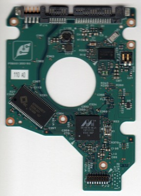

The drive definitely has the original PCB, I sure of that. My first DR guy thought the CPU might be fried only because he had replaced 3 bad chips and the drive and it still would not spin.
Doomer thanks for confirming that the s/n can be read from the ROM of a non-functioning PCB board
Yes the original image was from my scanner which cannot focus on a 3D object. I borrowed a camera and managed to get a better image of the board.

Better photo quality indicates that there is in fact no external ROM on this board; adaptive data is contained within the large Marvell CPU. However, I notice that there is a fuse missing at position F2 on the board. Short across the two contacts and see if the drive spins up. Don't know if your original guy already tried this but it's certainly not going to work without a jumper in place.
F2 has to be missing nothing wrong with it or around it

msurgeon:
This is a photo of my identical working PCB not the bad one (DR firm still has my bad one), so the fuse missing must be normal.
Doomer:
You misunderstood, the CPU wasn't removed from PCB 3 times, 3 other fried chips (possibly fuses?) were replaced on the PCB but he did never replaced CPU.
Sorry for confusion over the identity of the PCB in photo guys, but it was the only one I had here at the moment. Like I said it is from an identical drive thought, and the serial # is only a few digits off from the bad drive.
