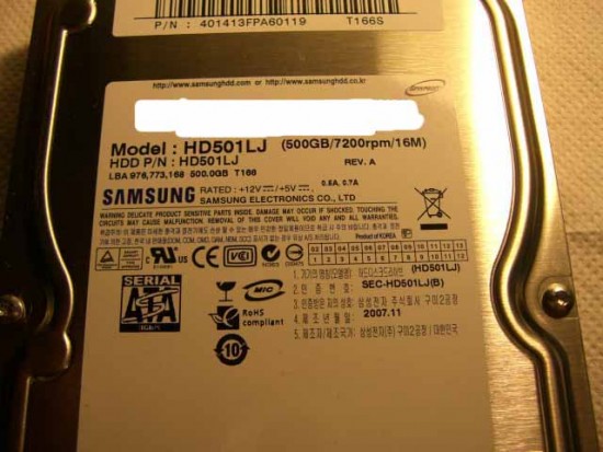

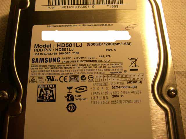

Yesterday, after a day of work I turned off my PC (unplugged the power cable from the contact because of thunder), later that evening, I plugged the power cable back in and I tried to boot... a deadly message showed up on my screen... "select proper boot device..." Argh, I opened up my case, and indeed BOTH my HD501LJ weren't spinning up when trying to boot! There was no reason to assume my HDD were in a bad shape (no clicking, ticking or whatever).
Because the sudden defect on both HDD's I assume that it's the PCB's thats causing the problem. However for replacement I need a new PCB, I googled around but I can't locate the firmware version and PCB REV... The closest description I found is the following:
"Samsung hard disk drives require a matching of firmware revision and also preferably same PCB REV. The firmware revision is normally labelled onto the flash firmware IC for older Samsung hard disks; however on the latest Samsung drives you will find the firmware revision on the top label http://www.ultratec.co.uk/images/PCB/fig9.jpg"
1. When I look at my HDD's I see REV.A but I can't seem to find the firmware version. Maybe I overlooked it but maybe someone can tell me where to look... http://www.storagereview.com/images/HD501LJ_top.jpg

you must match the firmware for it to work again like this
Rev . A
F/W: TW 100-08
it all must be the same
 Post subject: Re: Matching PCB for HD501LJ T166
PostPosted: November 17th, 2008, 5:10
Posts: 2984
Maych the date code as close as possible also

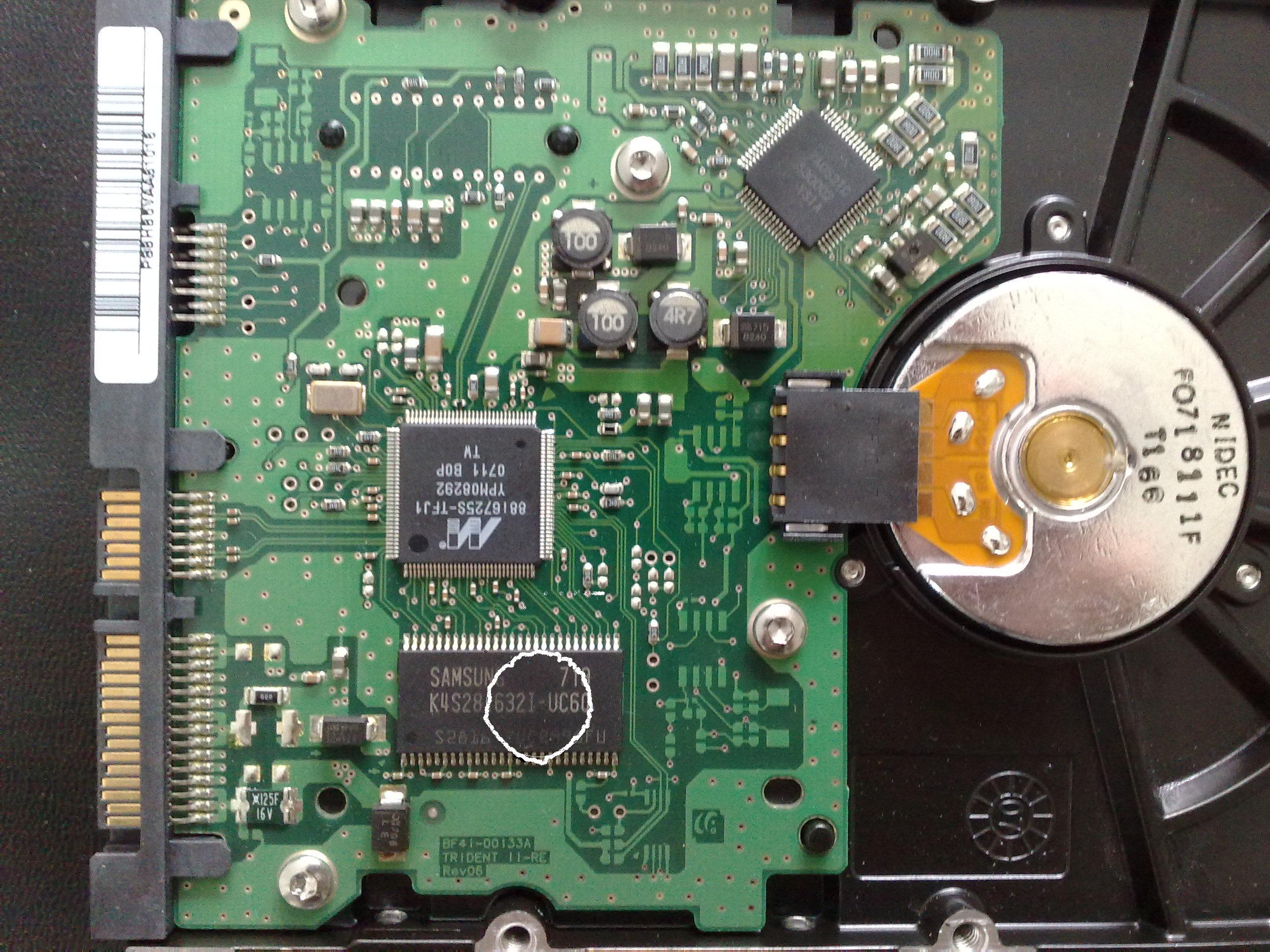

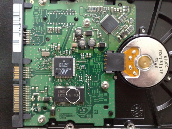

I have also just had a sudden failure of my drive. Mine was in a SUMO external enclosure.
Just stopped being recognised by my PC, accompanied by a nasty smell.
Looking at the drive, the chip with SAMSUNG written on it has a dark spot.
Some of the data on this drive is quite important, it was my back-up and archive drive.
Some of the archive stuff is unique now the original drives have been replaced.
So, is it possible to resurrect this drive with a new PCB and where could such an item be found, given that this drive is 3 years old?

Can we see a detailed photo of the PCB?
I'm not a DR guy, but AIUI, if the SDRAM has failed due to an overvoltage, then anything connected to the same supply would also be suspect. This would include the EEPROM and MCU. If your board has adaptive data stored in EEPROM, either internal to the MCU or external, then these data would probably be lost. These data would need to be transferred from patient to donor, so any damage to the EEPROM or MCU would mean that you would have to be very lucky with a replacement board.

Quick pic of pcb. Suspect chip is the lower one on the board "Samsung"
