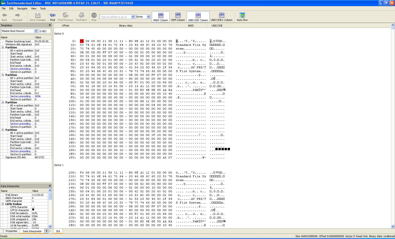

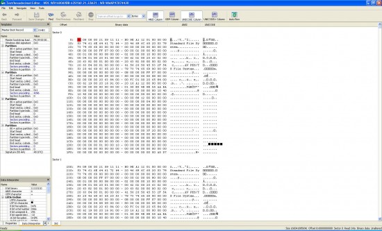

Bit #3 on the IDE interface is intermittent. It is sometimes high and sometimes low. I'd say that was an MCU problem rather than an interface problem.
The solution is to replace the board and transfer the chip at location U12 (if it exists) from patient to donor. Some PCB suppliers will do this for free.

I can't see any visible dry joints, but I would measure the voltages at each of the data pins. I would also check the resistances of each of the resistors connected to these pins.
http://pinouts.ru/HD/IdeInternal_pinout.shtml
Pin #13 (DD2, Data 2) appears to be the problematic one. AFAICT, R60 is its associated resistor.

I checked the resistance between pin #13 on the connector and the R60 resistor, which is infact where that pin connects to.
Resistance showed zero as expected, i also measure resistance of R60, that was 120 ohms which was similar to the other resistors near it..
The other side of R60 was leading to a pin of the main ic. So there doesn't seem to be any problem with that data line?
I also measured the voltage of the data pins, and pin #13 was 0,15 volts, similar to the other data pins..
One thing i noticed was that now i cannot get normal device id anymore in PC BIOS, even with shutting down/restart like i got it working before..
Now its "W@C WD1604AVBF-63WYA0" all the time.
So i think the problem is most propably with the pcb anyways? I think ill start searching for a replacement pcb.

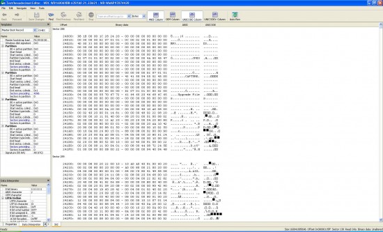

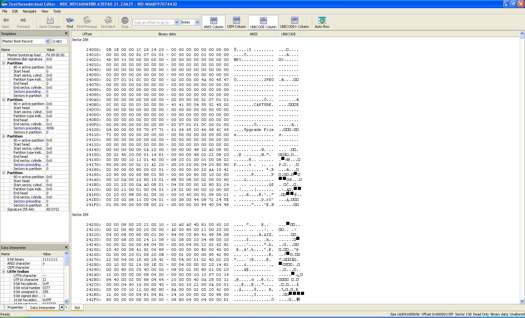

It cannot be anything other than a simple PCB problem. There is a consistent bit difference in data bit #2.
C:\debug
-e 100 "W@C WD1604AVBF-63WYA0"
-e 120 "WDC WD1600AVBB-63SYA0"
-d 100 13f
0100  57 40 43 20 57 44 31 36-30 34 41 56 42 46 2D 36   W@C WD1604AVBF-6
0110  33 57 59 41 30                                    3WYA0
0120  57 44 43 20 57 44 31 36-30 30 41 56 42 42 2D 36   WDC WD1600AVBB-6
0130  33 53 59 41 30                                    3SYA0
-q
These symptoms point to a "parallel" problem rather than a "serial" problem. That is, there is a fault in a parallel data bus. The data on the platters is recorded serially and the interface between the SA and the PCB is a serial one. This means that an SA problem would show up in random bits, not in one particular bit. In any case the SA modules have their integrity checked by way of a 32-bit checksum, plus each sector has its own ECC bytes.
AISI, there is a fault in data bit #2 of the IDE interface internal to the MCU. It is unlikely to be an SDRAM issue, since the ROM code and SA overlays are loaded into SDRAM and executed from there. Corrupt code would cause the drive to hang.

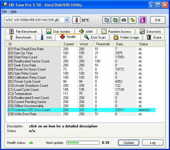

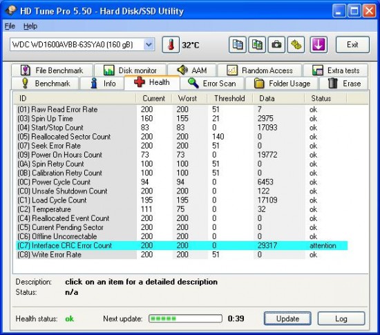

there are not any damaged sectors but smart status shows "CRC error count", this means that there were a lot of errors in datas communication between the pcb and your pvr recorder (probably your recorder has some issue, check all cables before installing again any hdd).
This can explain why your pcb got damaged!

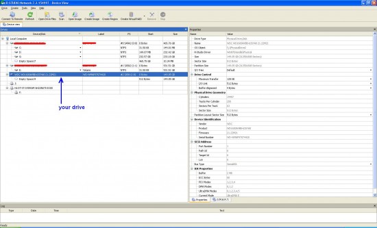

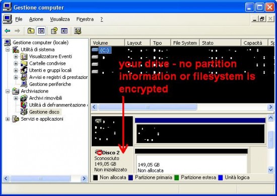

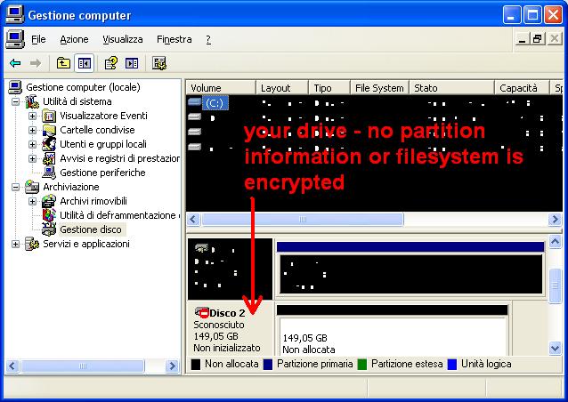

On my XP O.S. your partition is not shown but the drive is detected in "drive management" and in R-Studio.

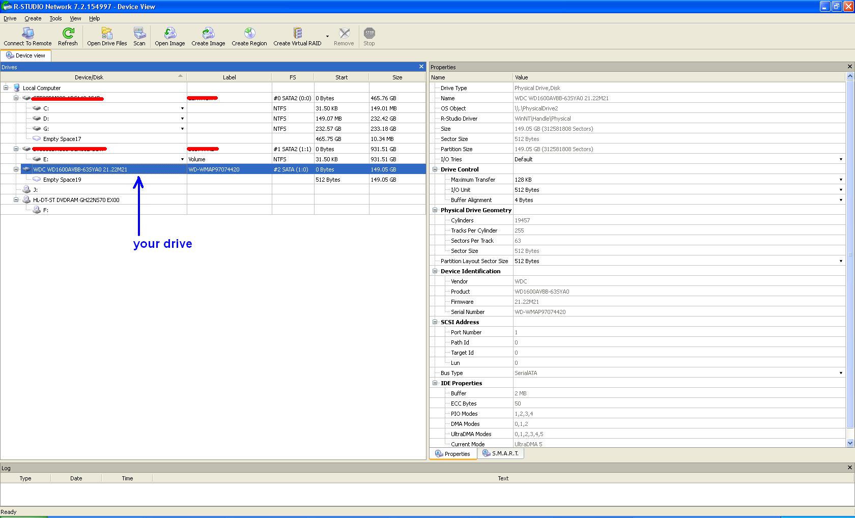

Sectors are accessible, i can see those in R-Studio:
Sectors from LBA 0 to 15 are identical.
Only at LBA 288 i can see few file index as MP3 and JPEG:
The file system installed on your PVR drive cannot be loaded in windows and either in linux so i'm not able to show you the main root, but maybe is possible to find some drivers to install on my computer that are able to load the file system.
Have you never attached this drive to your computer to see or copy files?
If yes, what drivers do you use to load this PVR partition on your computer?

Offsets 0x08 - 0x0B appear to represent the capacity of the drive in sectors.
0x12A19EB0 = 312 581 808 sectors
0x12A19EB0 x 512 = 160 041 885 696 bytes
The number of sectors is consistent with a WD 160GB drive:
http://www.farnell.com/datasheets/447660.pdf
My cursory examination of sector 0 suggests to me that there are several 32-bit words that look like the beginnings and sizes of several file system sections.
For example, offset 0x54 contains 0x120 (= 288). This appears to correlate with your "index" sector.
Other sectors of interest appear to be ...
    0x026320
    0x826320
    0x846320
    0x846520
    0x911620
    0x12A11620
