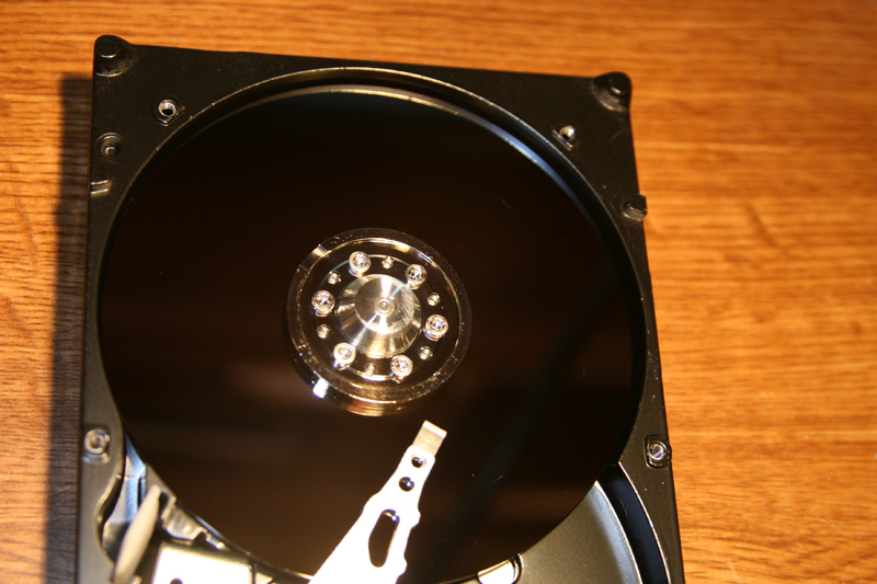

I am in desperate need of some expert advise. I have a hard drive with some not too important data as I have an old backup.... but here is my question I opened this hard drive to see if I had platter damage and I do... The question is can i recover some of the data at all.. The pcb looks fine no burntness or anything weird but as all computer components....... Looks can be deceiving. So I was wondering if there is a possibility to get some data is there a program that can check the pcb and tell me if all is ok.. and if not where would one go from there (get another board with same data and rev#'s somehow) or load some firmware to it... and is there a way to do all this without a pc3000??? also this is a western digital drive WD400 with clicking sound then drives spins down thanks for all your help
Steven.
P.S. I did clean the platters off with clean air and then sealed up right after opening it...
Also if you look closly at the image you can see 3 small like scratches kinda hard to see sorry :)

I suggest, to forget these data in this drive......
You had a really little chance, before opened it, but after you removed the top lid, you have destroyed the alignment of the mha, so, your chance is gone.
Only perfectly skilled pros can recover your data, with expensive tools, and this will cost you a lot of $.
If your data is not critical, simply drop this drive, and step forward........

I have to agree. There's no freeware that can help you here. PC3000 won't help. One really needs to know what they're doing before removing the lid. A Pro can probably get your data still, but I get the impression a pro is out of the question. You could spend years worth of effort, and many tens of thousands of dollars figuring out how to do this yourself, but then you'd have been better off just sending it to someone. Garbage, target practice, salvaging magnets, staging fake UFO pics with the platters, destroy with thermite on youtube, etc....

The only thing that really concerns me is the three scratches . . . but they are on the top of the drive where there is no head. Do they correspond to similar damage on the bottom side of the platter, and is the head bad also?
Assuming that you are lucky and there is no head / platter damage:
The PCB can fail on this model. You don't need the PC3000 to fix the board, if it is broken. Just swap the ROM chip with another PCB with the same sticker # on the bottom. Probably something like 2061-701292-000.
Recovery from this model is fairly easy. I did two of them this week, swapping heads in both and fixing one PCB. I don't think the fellow has ruined his chances of recovery simply by opening it. Getting the head stack re-aligned on a drive with one platter isn't too hard. In fact, one of the two drives that I swapped heads on needed no alignment after replacing the top platter.
Of course, it would help if the OP had a few drives to practice on. But I don't think it's anywhere near the big deal that others do. A WD2500 is another story entirely, for the same concerns that have been already voiced.
True, we don't know if the head is bad. But on a single platter WD400 ... head swaps couldn't be any easier. Or am I missing something?

Jon, you were lucky with your drives. I ALWAYS had to manually align (re-align) MHA on WDs, the first times it was a real pain in the ass. Now it's a bit easier, but still a pain... on the same location :)

+1 what Jon says, these lower density drives are easy to align. Sometimes when I'm bored I do it for fun. But larger drives w/ multiple platters, don't get me started.

Ok, you assume I don’t have a plan and you also assume I have never opened a hard drive before.... First off nothing was touched... Heads were not even slightly bumped....(So They Still Are Aligned) (Not even a fingerprint) just some fine dust you can see with my good digital canon camera.. I have opened several other hard drives one of which I did a test where I opened it let it sit open for several hours cleaned it off with air assembled and had that drive work for several weeks before any problems.(As An Experiment) (LIKE I SAID) since the data was not that important I wanted to make sure the platters weren’t badly damaged before I even attempted anything else.... And since there is a few scratches I wanted some advise not well since you opened it you’re screwed........ Now I may not be an expert here but I am sure that the data is still there.... Now weather I can get to it or not that's a different story... It's just some music and some pdf's and several documents.... all of which I have backups just a few of those doc's are several weeks old... So I was using this HD As a learning experiment.... (Next Time I won’t open it and will ask first) So now that's out of the way I see I should try a ROM chip from a matching pcb... so that leads me to is there a good source for pcb parts or just look for same hard drive on an auction???? Oh ya i almost forgot is there an easy way to see if the heads are messed up???? like a utility to run on the pcb or something??? Also how can you ruin the mha allignment just by opening the lid and not moving a single part??????

If you removed only the MHA's top screw, the alignment is gone.

With a lot of hour practice to get the skill, and some more hours and patience.
If you let the drive in the cleanroom for clicking some minute the platter can be damaged. (the head bounced back from the limiters)
If you let the drive without cleanroom for clicking a less minute, the platter will be damaged!
Janos

You can affix the cover with spindle screw only, and move the cover (ever so slightly) until you find the proper alignment.
