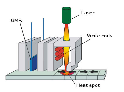

Yes, and if i have right, the asnwer is about the superparamegnetic effect.
The lower density drives not effected, because the magnetic domains have more place to fit.
I am really interested about this "lost with time" on the new perpendicular hdds... :)
For the storing, and avoiding the superparamagnetic, personally i like the hitachi's TAR solution. (Thermal Assistant Recording)
We will see.... :)
Janos
