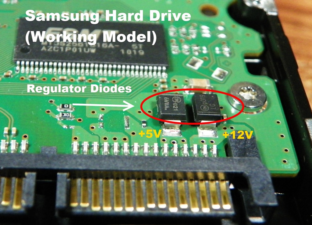

Hello, one of the diode in my seagate HDD st3160215as has burnt. The burnt diode is marked as ON QE R803. I may be wrong about the letters as the diode fried. There is another diode marked as ON 810 LEM next to the burnt diode.
Please, what should i do? Should i remove it or what?

desolder the bad diode, and then try and turn it on. Good Luck

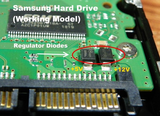

I think it is the 5v diode.
Here is the image, it not seagate but i am sure it is as same as my diode.
samsung-hard-drive-surface-mount-zener-diode-2011-06-01-003-copy.jpg [ 214.27 KiB | Viewed 5209 times ]
