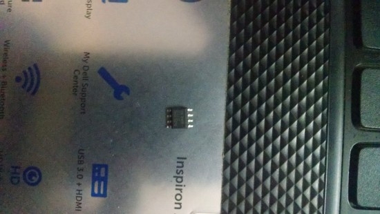

i am trying to program rom using tl866 universal programmer
on wd drive pcb 771672-004
ic no: winbond 25X20ALNIG
please help me where i am making mistake. programmer not reading the ic

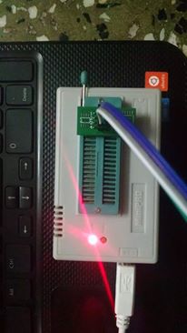

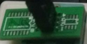

The adapter is inserted the wrong way around. The "1" needs to be at top-left, although it looks like the red lead is connected to pin 1 of the reader so double-check that the red lead of the clip is connected to the red dot on the IC.

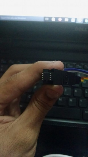

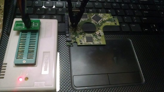

i insert the adapter as you told. but still getting same error
it is not reading it.
here is the situation please help

jermy wrote:
Have you tried to read it out of the circuit ?
rogfanther wrote:
Are you sure the socket or the clip are the right way ? My old eeprom burner informs a FF FF FF FF id when the chip is upside down.

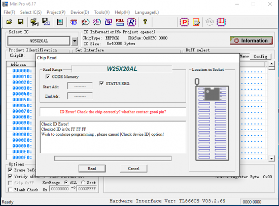

connection was wrong in the clip
but now i adjust it perfectly.

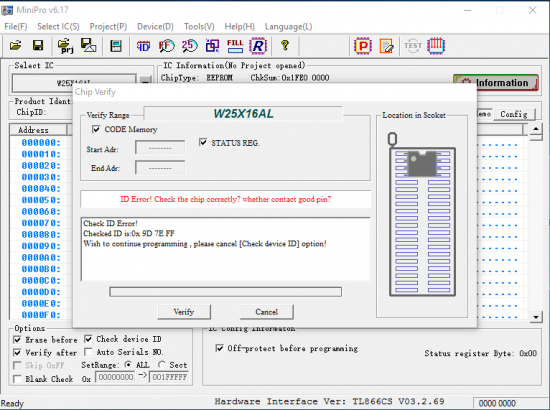

now this error encountering
 Post subject: Re: help! Rom recovery using tl866 programmer
PostPosted: August 28th, 2016, 15:51
Posts: 1388
Location: isreal
earlier you wrote:
Why have you selected now W25X16AL ?
Select W25X20AL
remove the V from check device ID
then read it
On your screenshot you have W25X16AL selected which is different to chip that you told us.
All you need to do is select the correct model and it should read fine.

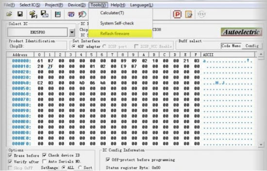

Can you must work Reflash Firmware tl866

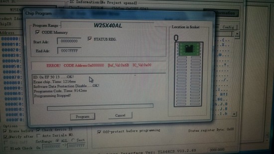

now i am getting this error ic is detected but this is giving error on rom writing
any idea why it is happening ?
PostPosted: September 3rd, 2016, 8:42
Posts: 738
Location: Ottawa, Canada
If I understand the screenshot correctly, it failed to write new content to the ROM? You could try it using a known-good/new ROM, to see if it is a bad IC. I had a lot of problems with read/write errors on mine so I bought a Revelprog IS unit instead. Besides, it handles low voltage ROMs whereas the TL866 doesn't. Have yet to have a problem with the Revelprog IS.
Also, I usually have to unsolder the IC from the PCB because other components in the circuit load down the programmer too much, causing bad reads. Is the ROM off the PCB when you try to write to it? Is the USB port used by the programmer on a hub? Use one directly connected to the PC motherboard, at the back of the PC.
