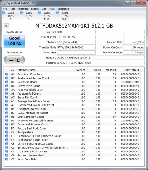

Could you show us the SMART info? How does CrystalDiskInfo identify it, ie model number, capacity, S/N, firmware version, etc?

Thanks for replying!!
Here is the Smart info.

Apart from attribute 0xBB, I can't see anything wrong in the SMART report.
The fact that you were able to apply a firmware update suggests that the drive is not password protected. Do you still have read access to the data on the drive?
