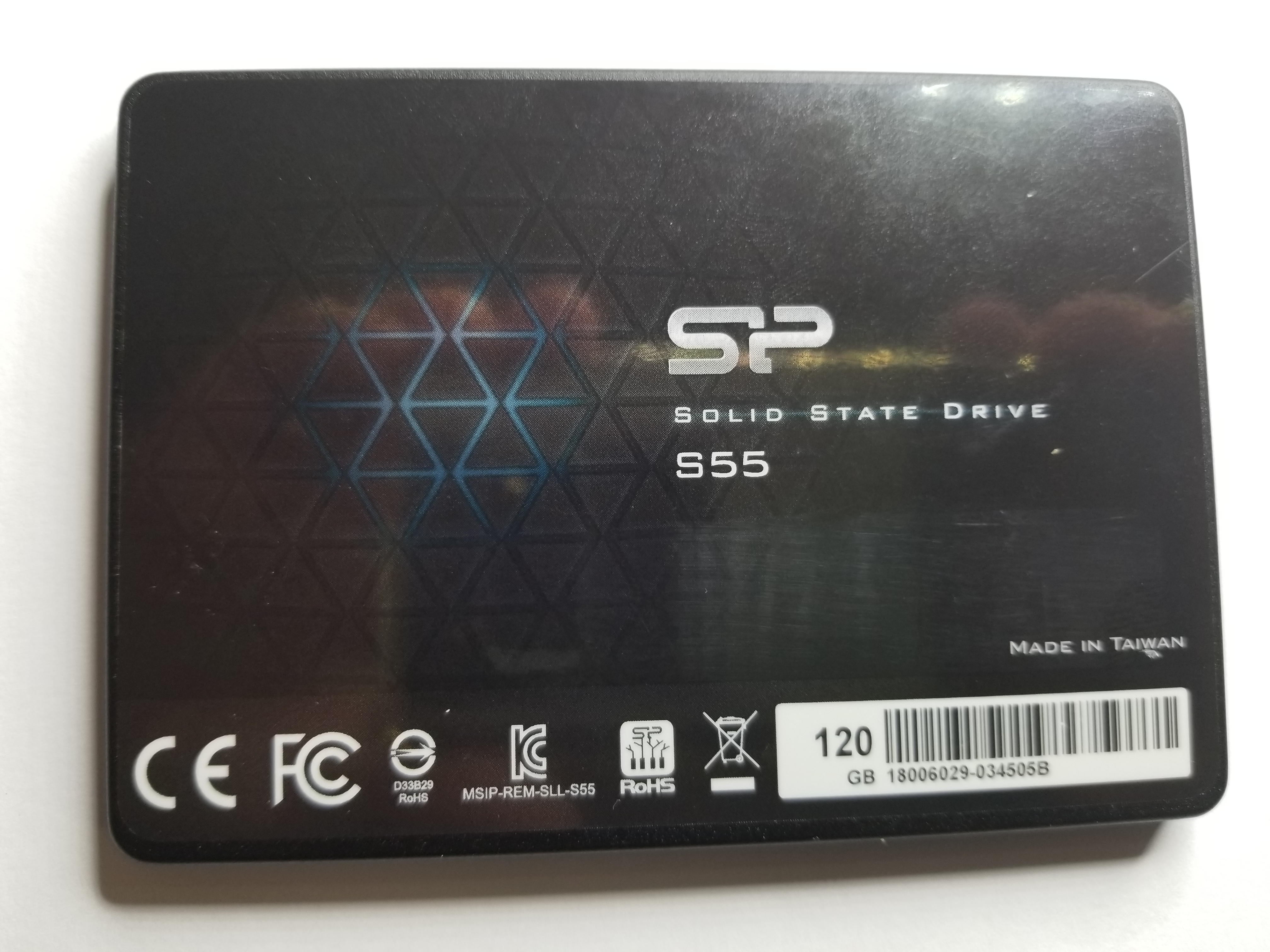

Anyone had experience with these SSD's. Pretty sure its FW as it goes BSY trying to read a sector.
Drive does ID with full volume.
I am able to get it into Safe mode, but as its not supported by PC3000.
IDs as a Seagate, but not sure it is as it has no com port like the other Seagate SSD's.
Controller is SM2258XT, but after Safe mode activated IDs as SM2258SB.

I had one and dumped NAND but looked encrypted. I don't like Silicon Power stuff, always been a pain
 Post subject: Re: SP SSD S55
PostPosted: July 12th, 2019, 11:20
Posts: 357
Had it few days ago. No solution yet. Ace doesn't know if or when it will be supported.

I'm wondering whether the following trick would work for this particular case:
In-circuit recovery of SSDs with "weak" NAND:
http://www.hddoracle.com/viewtopic.php?f=106&t=2740
I could help if someone would be willing to have a go.

The good thing about this PCB is that all 3 supply voltages have zero-ohm links between the Vouts and their respective loads. One would only need to identify the NAND supplies (by measuring the voltages at the zero-ohm links), then remove the appropriate link and connect a variable external supply to the load side of the link.

I would measure the voltages at V1, V2 and V3.
After you determine which of these is the NAND Vcc supply, remove its corresponding zero-ohm link and confirm whether on not Vcc now appears on any of the nearby capacitors, including those that I have not identified.
Could you also identify the markings on the buck converter ICs?
