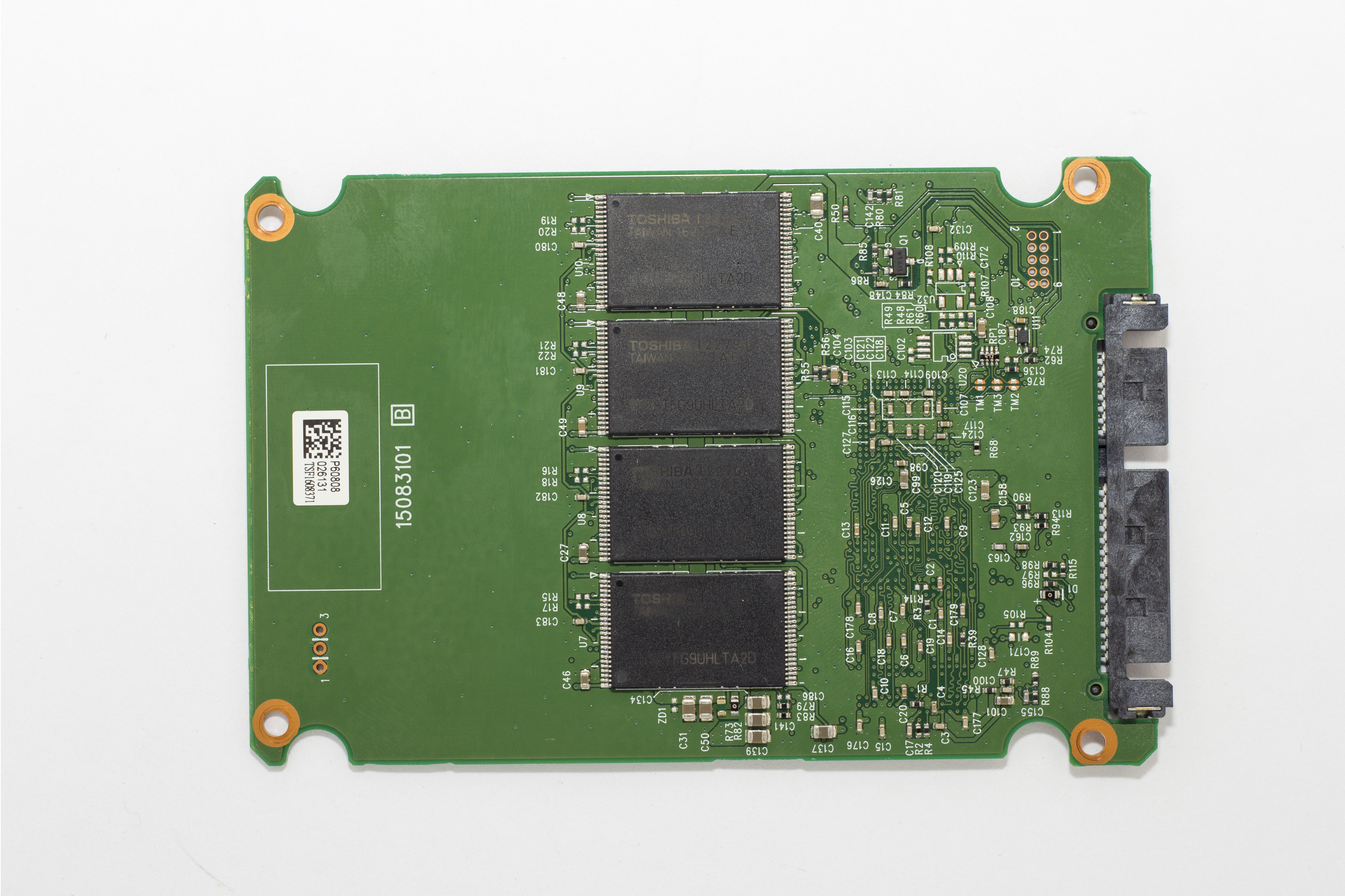

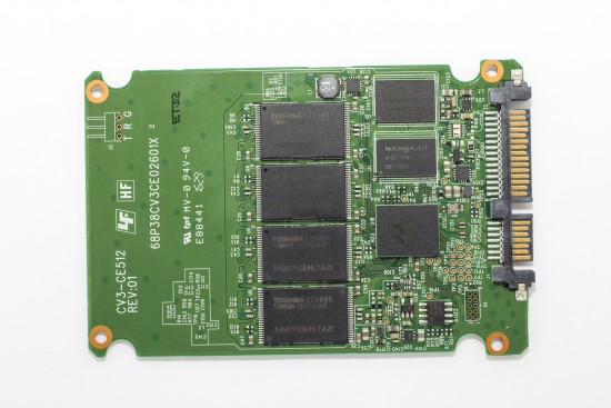

Hi there,
I have this LITEON CV3-CE512-11 SATA 512GB SSD with MARVELL 88SS1074-BSW2 controller.
First try: Drive came ready. I can Read ID. If i try to read sector result in BSY.
After lots of trials pwr on and off it started to work normally. I even copied 25GB of data with good speed of 65-70mb/s.
After a bad sector it get's back to square 1. Any sector i try result in BSY.
Aceab told me it is totally unsuported at firmware level.
So I tried In-circuit recovery of SSDs with "weak" NAND like described here http://www.hddoracle.com/viewtopic.php?f=106&t=2740
I noticed that around 2.425 - 2.450V it started to read, so i was very happy.
Not for long, because all read sectors are 44 44 44 44 44 44 44 44 44 44 44 44 44 44 44 44 DDDDDDDDDDDDDDDD.
I was using PC 3000 Flash as power supply and i thought it's not delivering enough amps (max 500mA).
But connected to a lab power supply it seems like it's only draining 70mA.
Any ideeas how to move further? Some new tricks maybe?
Thanks all.

Thanks all. Fully recovered.
 Post subject: Re: LITEON CV3-CE512-11 SATA 512GB
PostPosted: December 4th, 2019, 13:47
And the solution was? :-)
PostPosted: January 7th, 2020, 12:16
Joined: May 9th, 2017, 11:33
Posts: 155
Controller reballing and memory chips voltage variation.
