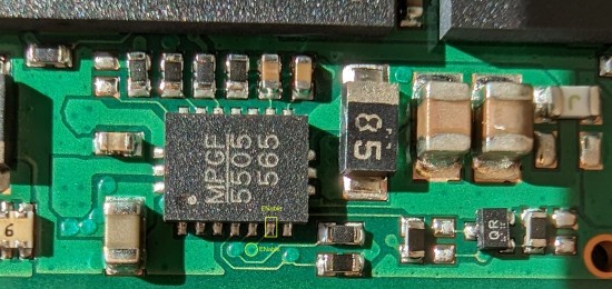

I had some trouble finding the SSD at first and then to find a matching pentalobe screwdriver bit that fit, but I eventually found what I needed and got it open. It's night time right now though so the pictures didn't turn out all that great.
https://imgur.com/a/1YsoSnu
I can try again tomorrow when there is more natural light, if needed.
 Post subject: Re: Unlocking ATA Password of PM863a SSD possible?
PostPosted: April 15th, 2023, 18:35
Posts: 17256
Referring to this photo ...
https://i.imgur.com/fPozb1R.jpeg

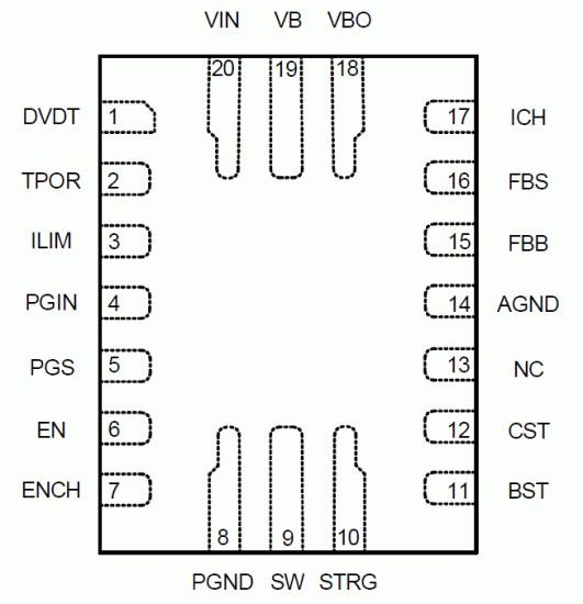

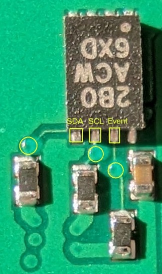

... there is an 8-pin IC in the centre of the PCB, immediately to the left of the NAND array. That's the temperature sensor. Also, there is a larger 20-pin chip below the NAND array (MP5505). That's the chip that controls the power loss protection circuitry.
Can you provide a close-up shot of each chip?
Power Loss Protection:
http://www.hddoracle.com/viewtopic.php?p=21248#p21248
If the EN pin of the MP5505 is not strapped directly to Vcc, ie if it is tied up to Vcc via a pullup resistor, then you can short this pin to ground while powering up the SSD, and then release the short after the SSD identifies itself. Hopefully this will induce ERRORMOD.
I updated the imgur link with more photos taken in daylight, including close-up shots of those two chips. :)

I suspect that the pinout of the temperature sensor may be similar to this IC:
http://ww1.microchip.com/downloads/en/DeviceDoc/20005192B.pdf
If so, then you could short SCL or SDA to ground during power-on and then release the short.
If it is, you may well find them on the i/o holes far bottom right.

I would try shorting SCL (temp sensor) or EN (MP5505) to ground, as explained previously.
