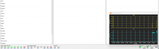

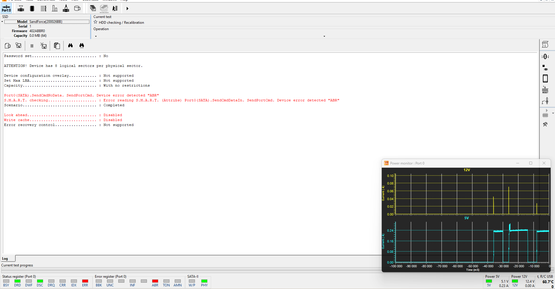

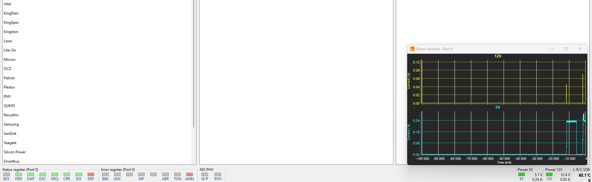

Yeah, but i mean the short is what makes the drive to not work
Here is the power without ROM pin shorted
Here is inside the utility with ROM pin shorted
 Post subject: Re: ADATA Premier Pro SP900 shorting everywhere
PostPosted: July 8th, 2026, 16:23
Posts: 17356
There is no short.
PostPosted: July 8th, 2026, 17:02
Posts: 17356
I should have said there is no short in your PC3k screenshot. Those areas you have marked out are capacitors. These are powered from the two DC-DC converters, U5 and U6. Measure the voltages at the inductors.
The fact that your controller identifies itself in ROM/safe mode suggests that its Vcore and Vio supplies must be OK, so that contradicts the claim that its bypass capacitors are shorted. Are you relying on a beeping multimeter, or are you actually measuring these resistances? What are the resistances between ground and each of the inductors?

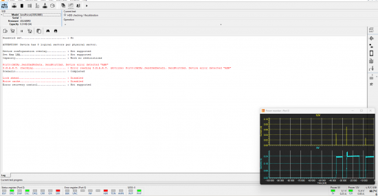

I will get a donor SSD soon. I will test it out on the donor
But i'm pretty sure that something is shorted
because the light indicators on PC3000 Portable Pro only shows that way when there is a short on the board. If the board is not shorted the light should came in BSY if there is a problem with Firmware of the drive
PostPosted: July 8th, 2026, 23:40
Posts: 17356
Just get your multimeter and measure those test points that I asked for. I suspect that you tested the Vcore bypass capacitors on the continuity range of your meter. This range often has a threshold of 100 ohms. Any resistance less than 100 ohms causes the meter to beep. An ARM core typically has a resistance of 100 ohms, so that is probably what you were measuring. Nothing else makes sense to me.

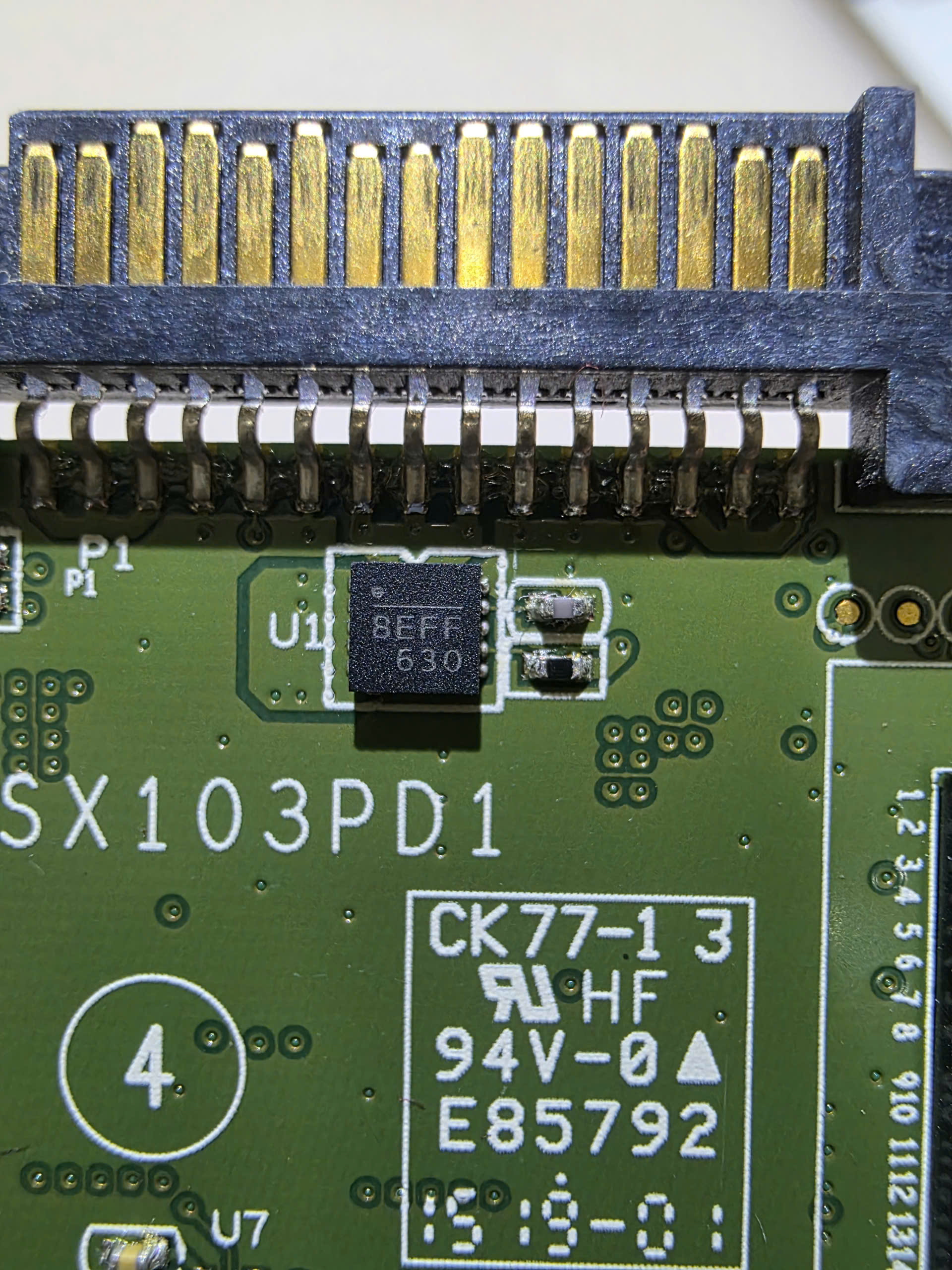

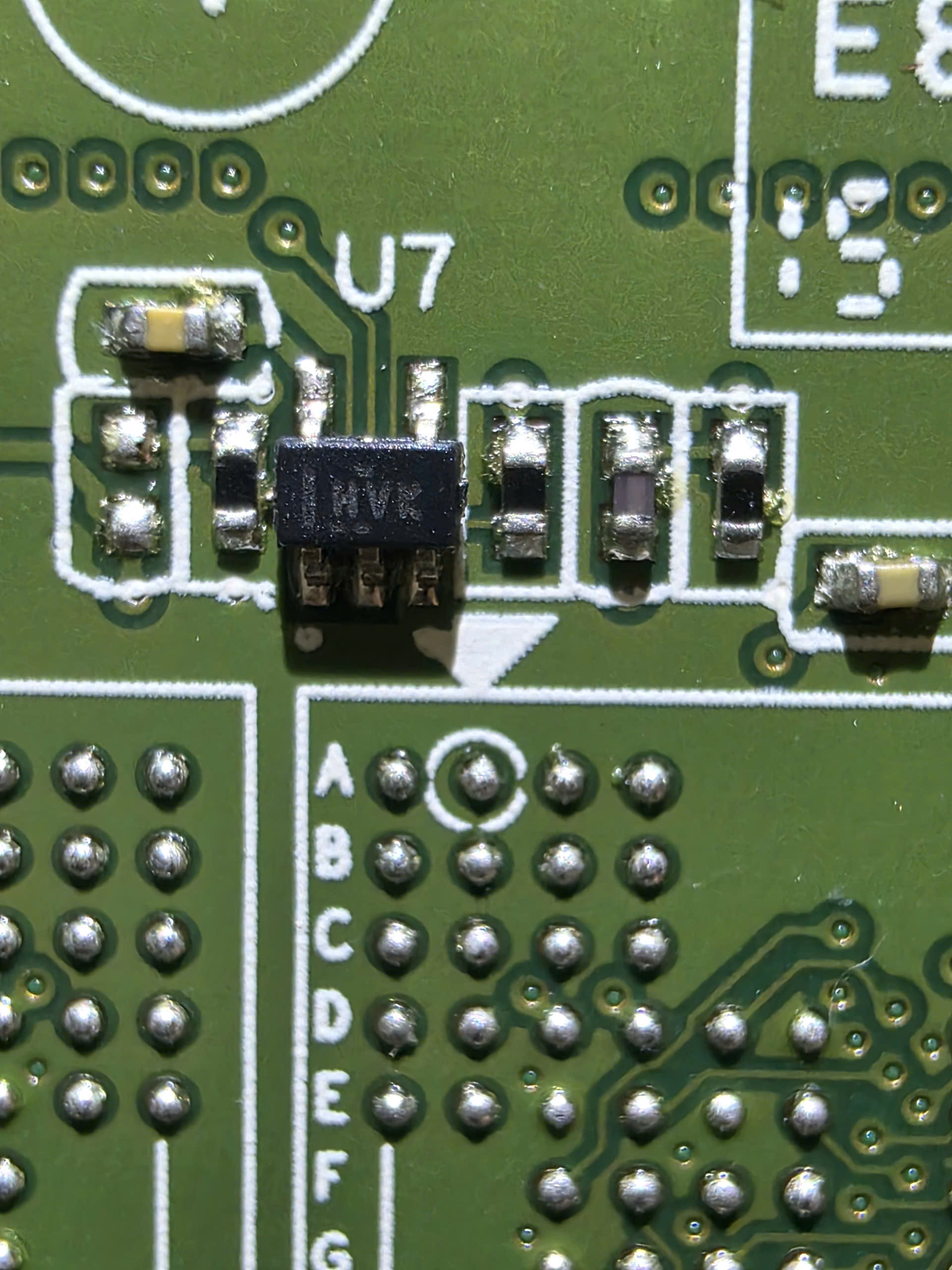

What are the markings on U7 and U1?
Capacitors that are shorted They are all 1V
U1
U7

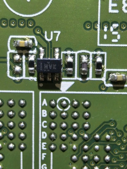

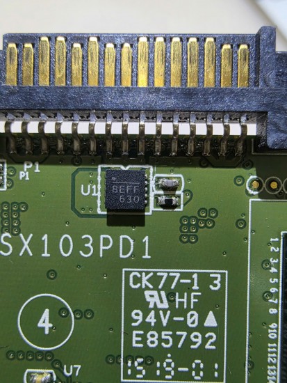

PostPosted: July 9th, 2026, 17:35
Posts: 17356
1V is Vcore, but then the resistances are 20 ohms versus 210 ohms. :?
HVK is a "single 0.8-V to 3.6-V low power buffer with open-drain outputs":
https://www.ti.com/packaging/en/docs/pa ... arking=hvk
BEFF is a Monolithic Power current-limited switch or e-fuse. There would be 5V on Vin and Vout, so that isn't your problem.

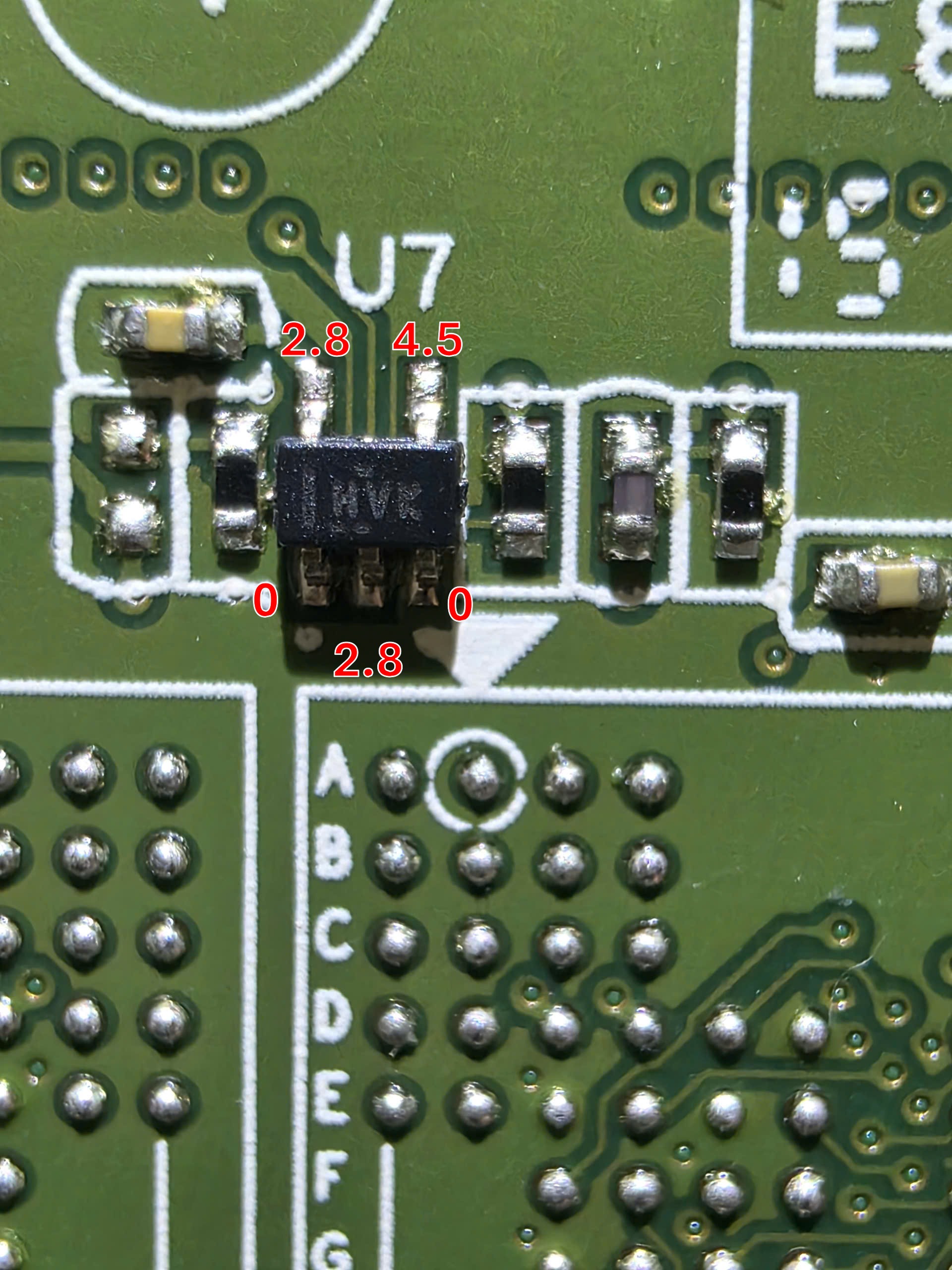

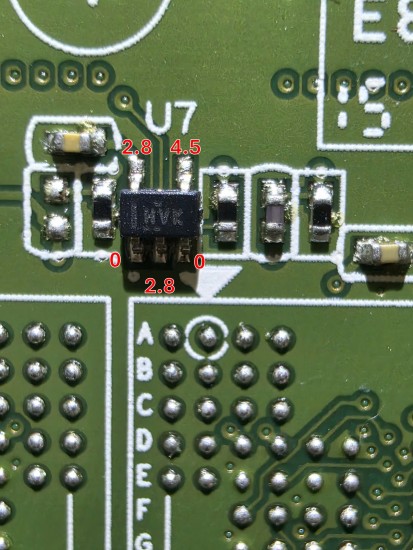

PostPosted: July 9th, 2026, 18:11
Posts: 267
Location: Vietnam
Here is U7 Voltages
PostPosted: July 9th, 2026, 18:23
Posts: 17356
I didn't mean to suggest that U7 was a potential problem. I was merely confirming that it wasn't power related.
