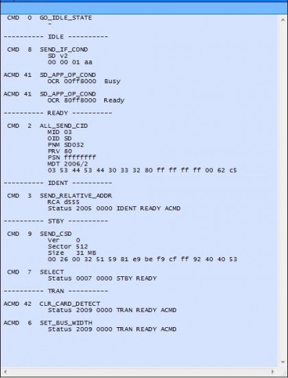

Yes, I used SD adapter on the one I mentioned. as soon as it would get to the point it would stop writing image. I don't have all details on hand but here is a log of a 64GB MicroSD
incorrect size detection
Reading this card via pinout produced dumps that could not be figured out, and there were things about them that looked wrong, dodgy to me.
There are some MP Tools that can work with some MicroSD cards, but I haven't looked into it much, and doubt would be that useful without knowing a lot more.
I believe controller has damaged firmware.
