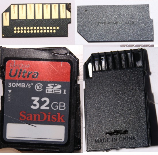

I have here a monolitic SD
I atach Pics
device manager do not recognize NAND memory
any of you knows any way to read data, maybe any af you knows pinout?, any other way?.

It looks like Ace's SDHC type 5 : http://www.pc3000flash.com/solbase/mono ... 8&lang=eng (login requiered)

Here is the SC equivalent link:
http://www.flash-extractor.com/library/ ... %20SD%201/ (Extractor Key Required)

You *might* be able to get it in this same method:
http://yifan.lu/2014/01/11/dumping-the-vita-nand/
