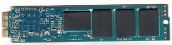

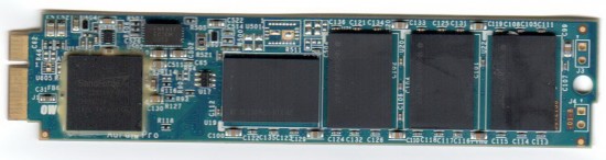

I got this SSD with SF chip set, it comes ready but after few minutes it get really hot and goes off line, I can cool it down and comes ready again, likely is a volt regulator but no able to figure which one it is, can someone give me a hand to recognize with component could be bad.

Which component is heating up?
I can identify U502 (NAND voltage regulator?), but the markings on U605 (Vcore regulator?) and U17 (LDO regulator?) are unclear.
EN6337QI, Enpirion, 3A Voltage Mode Synchronous Buck PWM DC-DC Converter with Integrated Inductor:

fzabkar...Both the controller and NAND chips are getting hot. And I do mean really hot. U605 is actually not populated by any component. Are you maybe referring to U606? Would be the small black chip just left of the EN6337QI and just above the controller in the picture. Its markings are ATBK H350. And U17 markings are T730.

rdallasb wrote:fzabkar...Both the controller and NAND chips are getting hot. And I do mean really hot. U605 is actually not populated by any component. Are you maybe referring to U606? Would be the small black chip just left of the EN6337QI and just above the controller in the picture. Its markings are ATBK H350. And U17 markings are T730.
Oops, I meant U606. The photo was unclear. "ATBK" looks like the marking code while H350 looks like a YWW date code (week 50 of 2013). I can't find any suitable candidate, though.
ISTM that the output voltage of the EN6337QI chip may be too high. I suspect it may be generating the voltage for the NAND array and the flash controller's Vio. I would check for a short between Vin and Vout. I would also check the voltage specs for the NAND chips. It would be risky, but if you are quick enough, you could measure the voltages across the capacitors adjacent to the NANDs. I wouldn't feel comfortable doing this, though.
U17 is an LM73 temperature sensor.
LM73CIMK, Texas Instruments, 2.7-V, SOT-23, 11- to 14-Bit Digital Temperature Sensor With 2-Wire Interface, marking T730:
http://www.ti.com/lit/ds/symlink/lm73.pdf
http://datasheet.octopart.com/LM73CIMK- ... 326679.pdf

Is it possible that the NAND chips get their supply voltage directly from the interface rather than the EN6337?? It would be an idea to determine which capacitors connect to the EN6337 and which connect to the interface.
