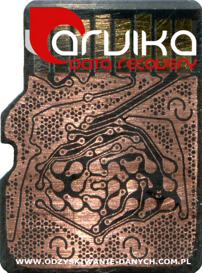

I check it remotely. At this case config is wrong, because pinout is wrong. It is 16-bit chip.

Arvika logged in and its been determined that this is a 16 bit MicroSD Card but there is no pinout in either PC3K Flash of VNR. Anyone happen to have the pinout?
