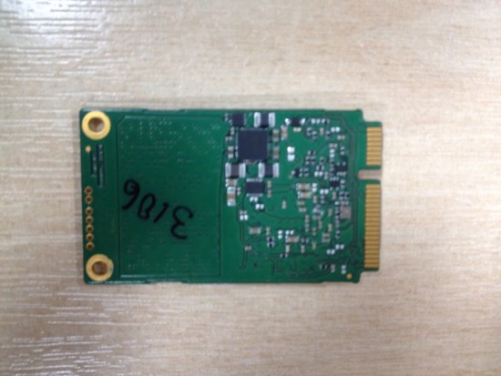

I have a Samsung SSD (Model: PM 851) that has recently failed. I have had it looked at by 2 data recovery companies who have independently confirmed that the processor/controller (which from my research I've discovered to be a 4th-generation 3-Core Cortex-R4 Samsung MDX Controller [S4LN045X01-8030]) has failed. I have been advised by the companies that the data is likely still residing on the NAND chips and that technically the data could be retrieved using 'chip off' techniques. They have further advised that this would be a futile exercise however as the processor/controller uses a unique XOR pattern which obfuscates the data, rendering the data, should it be recovered successfully, unreadable.
I have two questions that I am hoping someone may be able to help answer:
1. Is there any way of emulating the controller/processor programatically i.e. decoding and reassembling the data by finding the XOR key? Has anyone had success doing this?
2. Is there any way of repairing the controller or replacing it with another (set to use the same XOR key)? Again, if anyone has done this I'd like to know if it was successful.
Please understand that my knowledge of all this is very limited.

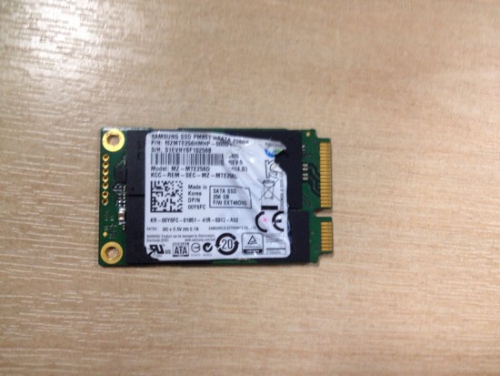

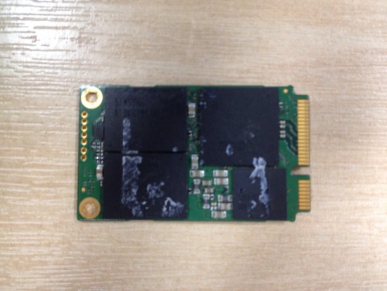

January 10th, 2017, 5:35
Hi Arkiva,
Thanks for the reply. Here are some photos of it attached.
I've done a little more reading since posting and I am being led to believe that even if I get the data of the chips it will be 256-bit encrypted, and unable to decode. Is that correct from what you know?
Thanks,
Matt

Please write description from memory modules. I'm curious what model it is used.

January 10th, 2017, 6:50
There is some description on chips: Samsung xxxxxxxxxxx Can you write it here, because I can't see from photo.
January 10th, 2017, 10:18
Sure, based on the last photo I attached, the text on the four large chips going clockwise from top-left to bottom-left are as follows:
Chip 1 (Top Left): Samsung 404 K90KGY8S7M-CCK0 HPL7189S
Chip 2 (Top Right): Samsung S4LN045X01 8030 N6ZKXA S1401 ARM
Chip 3 (Bottom Right - smaller chip): Samsung 404 K4P4G324EB FGC2
Chip 4 (Bottom Left): Samsung 404 K90GY8S7M-CCK0 HPL7189S
There is also a very tiny chip on this side of the board, which reads: 280ACW3NA
The board itself has the following printed on it: MZMTE256HMH0
Let me know if you need anymore info.
Many thanks
January 10th, 2017, 10:54
So memory chip it is BGA-316 type. There is no adapter for it. Theoretically we can read it manually by wire connection, but it is job for masochist. Chip has 16 or 32CE.
So for this case need wait for adapter or for solution which can repair FW drive (of course if it is FW problem).

The CPU and the 2 Flash chips are the same as EVO840.
I guess that the firmware is mostly identical to the EVO840, it just uses PCIe instead of SATA interface.
Interesting to see that the CPU is capable of both PCIe and SATA.
I think that most of the firmware research I did also applies to your case.
The memory module (K4P4G32...)
is also 512 MB, but it seems to have a different voltage level than the ones that are on the EVO 840. But that should not make a difference in practice.
That small chip is directly next to the 2 large identical flash chips, right? I think that's the I2C temperature sensor. Those are always located directly next to the flash chips to make sure that the connection is as short as possible so that they can measure the temperature fast and accurately.
The 5 golden pins seem to beJTAG. The 2 pins next to it could be SAFE mode or UART, I am not sure.
I found data that looks like crypto keying material for what seems to be 192 Bit keys, which could be for AES-256. Those keys seem to be fixed in the firmware, so perhaps you could try to replace the controller with a good donor controller, since they might all use the same keys.
If the SSD just does not want to start, I think it is more likely that one of the several bugs that I found in the firmware could have caused some memory corruption, which should be repairable in principle through JTAG.
In the past 2 weeks I wrote the memory map of the EVO840, at least all the hardware related things should apply to your controller as well:

It could be that every drive has a different key, yes. Or perhaps some other relevant parameters are different. I dont fully understand it yet, I am still researching it.
Yes, there are a few bugs in the controller firmware that can cause memory corruption which can lead to such Media Corruption, which can render the device inoperable, since the SSD verifies its integrity when it is powered up, and when it finds something damaged, it stops working to prevent further damage.
The manual wire connection would be to take the flash chips (Samsung 404 K90KGY8S7M) off and to solder small wires to their pins to connect to them, since there are no adapters on the market yet to read them easily.
For JTAG you have to connect to the easily accessible golden Vias at the edge of the board.
With JTAG you could connect to the controller and talk the controller, and diagnose and fix the problem it has with starting up. My theory is that you would get access to your data again as soon as you have fixed that problem in the controller.
