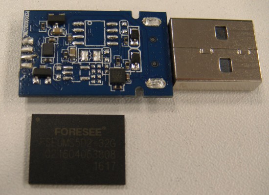

Hi, guys!
Did anyone encountered that kind of chip?
It was definitely a firmware problem so took it off.
- Attachments
March 16th, 2017, 21:56

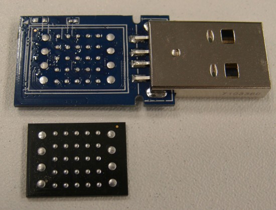

As there is no controller, and FORESEE are predominately a major vendor of eMMC and embedded nand+controllers, plus the fact there is no controller on the PCB, I would say you would need to find a datasheet. Likely a NAND + controller of some sort. This particular chip, I believe was made by Longsys, which does designing of controllers for Foresee.
These companies also do a lot of contract, non-publicised work, Think military, and chips such as this can be refurbished from odd jobs and repackaged mainstream, meaning even the company will deny knowledge of it.
I would be looking for BGA33, VFBGA33, FBGA depending on what they think is fine or very fine.. or BGA25 if they do not count the stability pads.
Or measure the package with vernier callipers and look for that size during a search
I would be very interested to see the case this was in.
I don't think there is going to be raw nand access, maybe fire up a logic analyser and look for SD or emmc signals

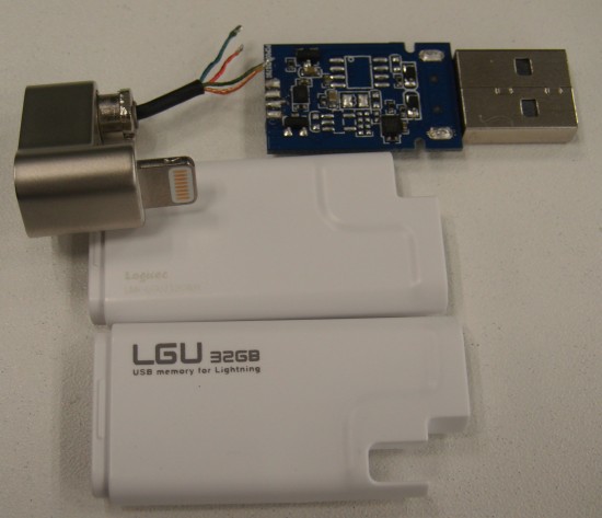

The package is as follows.
As you may see it has also a lightning connector.
The USB itself wasn't recognized by the computer.
In HEX it showed 5.5 kb partition gap filled with zeros and that was it.
So I thought it was a FW issue and removed the chip.
- Attachments

In that case I would try:
- Resolder chip on.
- plug into windows machine with DMDE installed, and have DMDE shortcut somewhere you don't need to browse for it. Idea is to not do any un-necessary file, folder access. example a shortcut on taskbar.
- DO NOT open any file manager windows, close any that pop up.
-with drive in USB slot, open DMDE and take an image of whole device (ignore any partitions)
if you get I/O error:
- firmware could be corrupt
- NAND could be damaged
- wire bond internally could be broken
- electronics component could be faulty or out of spec.
if you get a good image but no files, such as all 0x00 or 0xFF
-device could be formatted / wiped
- firmware issues / bug
in flash there are many possibilities. You can NEVER say "obviously it is.." unless you see physical damage and rectify it. Just too many variables.
best case is filesystem is damaged but raw recovery will work
Interesting device, I wonder if there was a PC based way to access from the lightning side..
March 17th, 2017, 1:03
In WinHex there was only one partition - 5.5 kb. So I cannon take the dump of whole device.
Tried connecting it to an iPhone - nothing happened
I agree the possibilities of damage are vast and unexpected
Will try finding a datasheet.
Thank you
