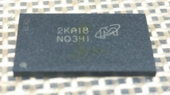

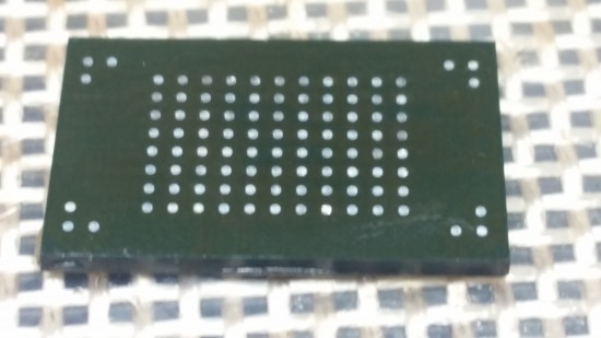

Just got a Lexar CF Card in with these chips. I cannot find the specs from the number on the chip. Are they BGA 152?
Re: Is This a BGA 152 Chip
October 27th, 2017, 15:47
It's BGA100 chip - there are sockets or direct BGA boards for this. You can look in VNR standard set ;)

Hhhmmm. None of the 4 chips will ID. I think its the first time I have had BGA100 chips in, so it may be a bad socket :(. I will send it back to VNR for testing.

I tested a few other BGA100 chips I had and none of them would ID. I have just reballed the first chip from the case and soldered it to the PC3000 Flash BGA100 module and it has ID'd and is now reading. Just unlucky to have a bad socket I guess. The service from VNR is normally pretty good, so I will send it back for testing. They may learn from what has gone wrong with this one. Thanks for the replies.

Here images for you for BGA 152 And BGA 132
1 : Image
2 : Image

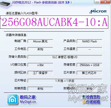

The chip is Micron MT29F256G08AUCABK4-10:A, where 'K4' is the package code.
Micron's use 'H1', 'H2, and 'H3' codes for their BGA100 depending on the package thickness, but I can't find any information about 'K4' code.
I suspect that this chip may have an non-standard package or pinout.
BTW, they have a very similar chip with a standard package code: "MT29F256G08AUCABH3-10:A".

FWIW ...
NAND Flash Component Part Numbering Guide - SpecTek:
https://www.spectek.com/pdfs/SpecTek_pns_Flash.pdf
    H1 = 100-ball VBGA, 12 x 18 x 1.0
    H2 = 100-ball TBGA, 12 x 18 x 1.2
    H3 = 100-ball LBGA, 12 x 18 x 1.4
    K3 = 100-ball VLGA 12 x 18 x 0.9
    K4 = 100-ball TLGA, 12 x 18 x 1.1
