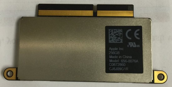

December 13th, 2017, 23:04
Does anybody knows of any adapter to read data out of this SSD ?

December 14th, 2017, 4:11
This is Pcie 3.0 HDD. I have not sean adapters for this model.
It is possible to solder connection to a Pcie 3 M.2 adapter , but You also need computer that suppport PCI-E 3.0.
Also this HDD is encrypted in my opinion so You could only image it to another HDD without direct access to user data.
Can't You just instal this HDD in another Macbook?

I don't think any adapter exists for those just yet. I'm sure in 6-8 months you'll see something pop up on one of these sites:
http://www.pc-adapter.net/categories/0/0/57/1.htmlhttp://www.microsatacables.com/drive-ad ... sd-adapterFor now, you'd better quote planning to solder up a custom adapter and pray that you get the power polarity right the first time.

data-medics wrote:For now, you'd better quote planning to solder up a custom adapter and pray that you get the power polarity right the first time. :shock:
A competent technician should have no trouble locating the power pins. There is no need to plug and pray.

Given that he only has 13 posts here I'm not making the assumption that he is an electronics master like you.
Besides, often chips on these Apple SSDs are sold only to them with little to no documentation available. I'm just saying that if you mix something up and send the wrong voltage somewhere while rigging up your own it could be an expensive mistake. Even to do this on a test subject will set you back $350. So you've got to plan that possibility into the risk factor of your pricing.

data-medics wrote:Given that he only has 13 posts here I'm not making the assumption that he is an electronics master like you. :roll:
You don't need documentation, or a university degree, to find the power pins, assuming you can see both sides of the PCB.
data-medics wrote:I'm just saying that if you mix something up and send the wrong voltage somewhere while rigging up your own it could be an expensive mistake. Even to do this on a test subject will set you back $350. So you've got to plan that possibility into the risk factor of your pricing.
A "professional" should not need to factor incompetence into his pricing, nor should he ever play Russian roulette with his client's data.

We received one of these SSDs in for the first time a few days ago. Currently looking for an adapter. Some information on these can be found here:
Step 11 at:
https://www.ifixit.com/Teardown/MacBook ... down/72415https://beetstech.com/blog/apple-propri ... des#hdr-22Reported details on the SSDs:
SanDisk SDRQKBDC4 064G 64 GB NAND flash memory (x4 for a total of 256 GB).
Apple 338S00227
Texas Instruments 58879D MOSFET
F4432ACPE-GD-F likely Micron 512 MB DDR2 RAM
