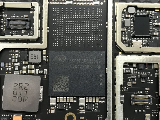

Hi everyone!
Have anyone seen this chip?
Is there any kind of interface for that?

It is strange the chip part number is the same as Intel SSD Part Numbers. maybe a fully integrated drive on a chip, a monolith SSD essentially?

"A fully integrated drive on a chip" sounds to be right.

Here is a SATA/PATA "SSD on a chip" (Silicon Motion FerriSSD):
http://static6.arrow.com/aropdfconversion/e34a936206aef41642e4466404978f1b53963ba5/ferrissdproductbrief_eng.pdf
http://www.storagesearch.com/ferrissd.pdf
Toshiba and Samsung both have NVMe SSD-on-a-chip products.
I suspect that the vacant BGA location above the Intel chip is reserved for a second SSD. This should make it easier to determine the pinning for the supply rails and interface signals.

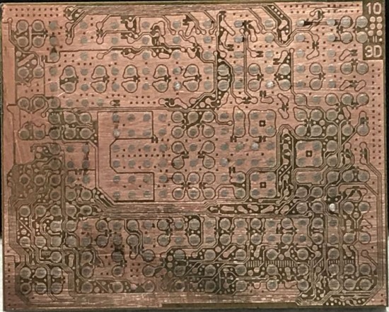

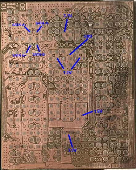

It wouldn't be too bad to just wire it up like a monolith I suppose. I doubt it'd require power input on all the different voltages either. My guess is it's just different options the manufacturer can opt to use to power it. I'd guess that just using the 3.3 or 1.8 would suffice.

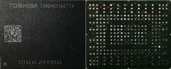

Toshiba SSD Connection Points.jpg (75.53 KiB) Viewed 38099 times
