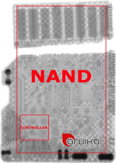

Hi, I have a Samsung 64GB Micro SD completely split about 5-10mm from the contact pins. I read that if there is luck and it has not affected the flash memory, the data can be recovered. I have looked at photos on the internet to know how is a micro sd inside and I see only pinout zone ... in the old non-monolithic cards you saw the chip nand in an obvious and easy way ...But where is that chip in monolithic cards ?

I post some info few days ago on FB about this: https://www.facebook.com/arvikadatareco ... 3781020613

fender, did you read articles form links. MicroSD cards are so small that memory module cover almost all of the card surface inside.

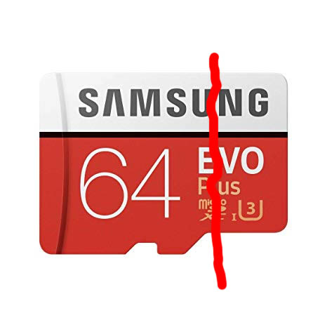

I show you an image of where the card has been broken.

IMHO game over. If you see light reflex in crack it means that you see cracked nand module.
Moreover even if memory module alive, there is no method so far to recover data from dumps.

fender, if you check HaQue, links you will see on photo with decapsulated MicroSD that memory module cover about 95% of surface inside. While on your photo crack "split" card in proportion ~ 75%/25%. However you would not combine crack always will be on nand module.
On my link crack is near border of card. Client have lucky and memory module alive. Recovery was possible.
About second question: Pinout for your card is probably known. But even if somebody read dump (it is possible for not cracked cards), there will be problem with assembling data (alghoritm for this card is not "cracked" yet :D )

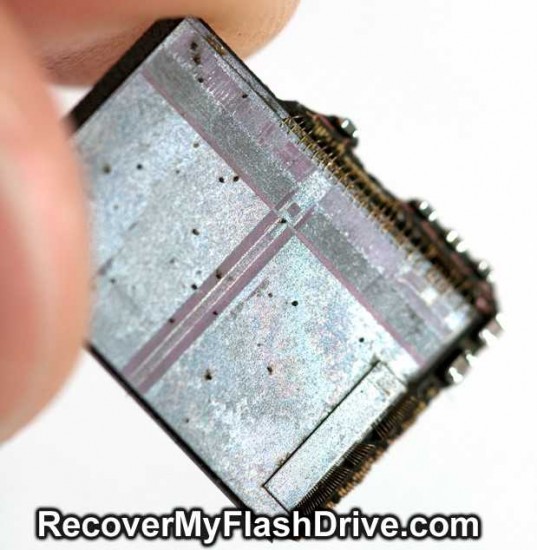

MicroSD card I decapped a while back, NAND is the size of the MicroSD card.

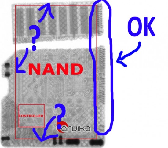

arvika one question, It's just curiosity. but , how do you know with this x-ray picture where is nand memory?

fender, compare jeremyb photo and mine. You will see bond connections to nand.

arvika wrote:fender, compare jeremyb photo and mine. You will see bond connections to nand.
I guess you mean the connections I've marked as ok, am I right? but in that case we only know the height of the chip, but not the width ... at least I'm not able to see connections that tell me how wide it is.
Sorry for being insistent, I am very curious and the subject seems very interesting.

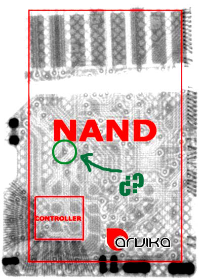

Maybe you mean each of these points? Sorry for my ignorance.
