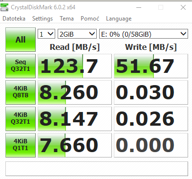

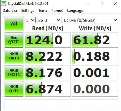

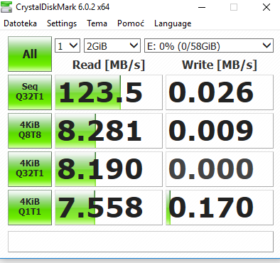

ok, I tryed Crystal disk mark test with couple of different allocation sizes. I set set size to 2GB (maybe to eliminate cache memory??).
Tested with allocation size 32k, then I quick formated usb stick and selected default option and after formating it was set to 128K (how is that default?) and for the last test I used smallest size 4096 bytes.
- Why is speed to small on 128K test? Should I set test on more passes? Now I am worried that something is not wrong with USB...
- Is there a program that can verify me the USB stick health?
- Can you give me instructions in what program (is Crystal mark the best?) to test and how?
Stick is Adata S102 pro 64GB.

What does it test, I have never used it? If it does not actually create files but writes data from LAB x to LBA y then clustersize is moot, right?

All I'm saying is:
1. If the benchmark you used tests the drive by writing/reading from LBA 0 to last LBA on the drive then the clustersize is not relevant. You need to measure how the drive handles files vs a certain clustersize.
2. Maybe more important than the clustersize is if clusters are aligned with the let's say physical layer underneath. If clusters overlap the boundary of the smallest block that can be read/written at once then the device needs to read/write 2 of those rather than one. A FAT based volume roughly looks like: boot record - FAT area - data area. If for whatever reason the data area starts at an odd sector number I am guessing all access to the drive will be slowed down. The reserved sectors number in the boot record would allow you to 'shift' the start of the data area to an even sector address.

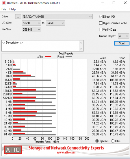

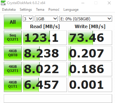

Thak you all for answers. For final test (1gb test size) I decided to set it on 16K allocation (probably won't change this, my final allocation). I expected higher 4KiB values in Crystal mark, some other cheaper stick have there around 2-3mb speed.
Why on ATTO is so many speed oscilation? Mostly benchmark I see in ATTO have normal stable scale.

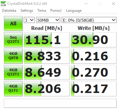

And why on 50mb test I get slower speed? For now I don't care about allocation I just want to verify that usb is working correctly. For example this amazon review (50mb crystal mark test) seems to have much higher speed than mine:
