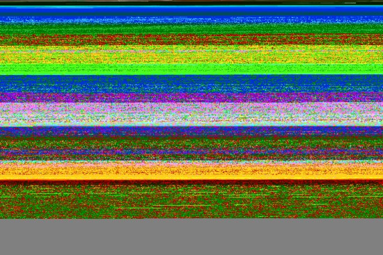

Ah. Well these are photos shot using a Canon EOS. So I noticed in header Canon corrupts in to Cankn, EOS into EKS, Exif into Exib. In each of these files. You'd expect bit errors to be a bit more random, no?
Exif - Exib
01100110 - f changed into
01100010 - b
Canon - Cankn
01101111 - o changed into
01101011 - k
EOS - EKS
01001111 - O changed into
01001011 - K
Each time the 6th bit flips from 1 to 0.

Personally I am not aware of a specific hardware issue that would cause this. But a failing controller I guess could cause it, especially if the flash drive uses inversion. Have you tried using an image rebuilding program like disktuna.com.
Re: Help! need to refer someone for SDcard in dominican repu
November 19th, 2019, 12:15
lol.
Yes, that's how she ended up with me. I am disktuna.com. She asked if I can repair the files. But these flipping bits spread across the entire file. If I only flip back the ones in bitstream that result in invalid markers, after replacing header with a good one I get psychedelic stuff like this.
November 19th, 2019, 12:20
I just had a PM from a friend who is too shy to post on this forum......
He had a case where two data lines were shorted (D8 and D9) resulting in a very similar issue to this. I guess if it is every 6th bit which is flipped it would be possible to write a script to revert them.

But, it's not each and every 6th bit as far as I can tell. So I am still trying to see if there's some pattern. And if I find such a pattern I will have to flip back the entire card, I think it goes through the entire card.
But ideally I get an address where the lady can send the drive to. Because trying to get a disk image from her appears to be too much asked already. Someone who can d chip-off if needed maybe to bypass faulty electronics and such? That's beyond what I do, I don't have the equipment for that.
