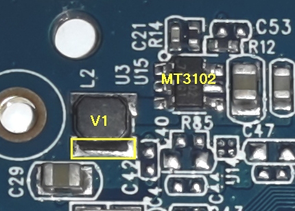

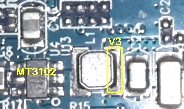

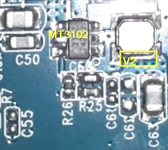

I guess some component failure on PCB . Anyone could assist which point voltages should I measure. Or which components resistance

MT3102, M3Tek, 1.5A Continuous 2A Peak 5V Input 2.5MHz Synchronous Step-Down Converter, marking 3102, DFN_6L:
https://www.m3tekic.com/upload/2016/08/20160826154353.pdf
Quicker-and-dirtier switchmode regulator:
http://www.hddoracle.com/viewtopic.php?f=59&t=231&p=8909#p16236

February 10th, 2020, 17:05
V1 =1.00 V
V2 =1.78 V
V3 =3.00 V
