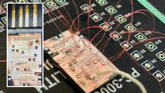

The premise of recovering data from a broken flash drive is that the NAND chip is not fatally damaged. I am from China, and I am good at dealing with difficult problems that others can't do. This is a broken drive that I managed to recover data last week :cool:
If you need to, I can try, but if you can prepare a identical donor to let me find the pin arrangement.
So I recorded a video to record the moment:https://www.bilibili.com/video/BV1sk4y1y7Tj/

csava, yes, but remember Flash is much bigger than MicroSD. and there is much more chance that memory module will be untouched when it crack. At MicroSD memory module cover almost all surface inside, so only crack near the edge can save memory module. Each crack at the middle - you can be sure that recovery is impossible.

It doesn't matter how hard a company works. This flash is easy enough to solder up, pinout is likely known. but no amount of skill will put a crystal NAND chip back together after it is cracked.
It also is irrelevant how important the data is, or how much money is thrown out it

In fact, many cases, even if they seem simple, will fail in the actual operation, which is normal. There are also many seemingly impossible tasks that are actually done. It depends on the technology, but luck is also very important. I once found a crack in the CPU of a customer's notebook computer from the middle, but this does not affect the normal operation of the CPU. Of course, if there is a crack, it can still work normally. This itself is a small probability event, but if you don't try to 100% fail, you may still have a small probability to win.

When encountering difficult and almost impossible cases, people often say that it is impossible to accomplish, and no one can accomplish it. They even laugh at those who are willing to spend their energy trying: Hey, that silly boy is doing useless work again. If you don't try it, then there is definitely no hope. God will not favor those who do not act. I hate to use inertial thinking to solve problems, and I should be very clear in this work. If the case is a cheap advertising flash drive, then most of it needs reverse engineering to compile. In fact, there are some programs that do not support PC3K, FE, or VNR, but we can get it done. This is not to say how good we are, but the most popular flash memory products used by consumers in each country, and local data recovery companies know more about it. Many tasks that seem impossible to complete are also done. So I never tell the client whether it can be done or not, I will only tell the client the expected probability of the success of this task. The probability of failure is 99.9%. As long as the customer can accept it, he will try his best.

Hello brother, you must know a few things before entrusting the micro TF card to me. First of all, the judgements of the above engineers are highly likely to be correct, just as they said. But it is not absolute. Experience tells me that there is no absolute in everything, because if part of the crystal breaks in a non-critical position, it will not kill it. Just like during World War II, some soldiers had their brains penetrated by bullets, but they still survived. So luck is the key, and the flash memory survived by fluke. Reading it correctly and turning it into what you need is also a very complicated process. As we all know, even a micro TF card with a complete appearance is much more difficult to recover data than Monolithic UFD and traditional flash drives, but this is not a problem, I can basically handle it. So you must understand this before entrusting it to me, because the probability of failure is still 99.9%. I know this very well, but I am willing to try, but you must also be aware of this. In the worst case, you may waste the cost of an international express, and I may waste a few days. Please contact me by email: cscsava1@gmail.com
