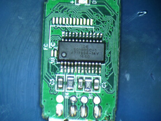

Anyone know the pinout for this controller?
IDE - 5019BSC-1
After some research it appears it may be an unbranded Alcor, but that is as far as I have got.

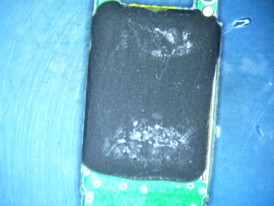

NAND chip is just a blob under hard conformal.
Any help would be appreciated.

It looks like the PCB is laid out for two controllers, "AU" (Alcor Micro) and "FC" (FirstChip). Perhaps you could find a known "FC" controller in a 24-pin package which matches the 5V, ground, 3.3V (?) and Data +/- pins? Then you could work backwards and translate the pinout of the IDE chip (like the Rosetta Stone).

I had very similar one. Sadly it was dymanic XOR.
Pinout should be easy to find.
Re: Anyone seen this Controller?
September 22nd, 2020, 8:19
i had one as well, reversed the pinout (sent to Tim already), but as far as i can recall the job was stuck somewhere else. Maybe due to dyn xor as Melvin said...

Thanks for the replies. As pepe said he sent me his pinout (much appreciated), so I will try today and let you know the outcome.

http://www.flash-extractor.com/library/ ... 94_da__1x1
This IDE5019 appears to be a re-badged AU controller.
