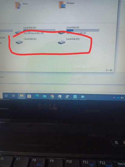

after the repair, now I cant access the drive and data.
plugging it in any computer freezes windows and everything gets back to normal once I eject the SSD.

this is what I see now that windows repair happened

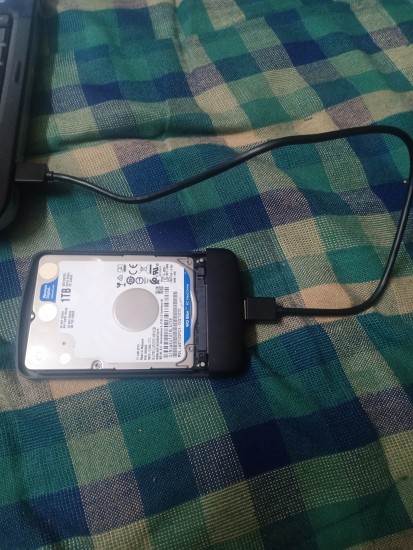

the old SSD which I connected to copy my data

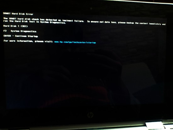

the error my laptop showed when the SSD had crashed

It's not an SSD.
It's a Palmer HDD.

Your drive is having SMART errors, we don't know which, but most likely it has degraded significantly. Here are a few things you can do:

Having said that, if your data is of no important value, connect your drive through SATA (not USB), download CrystalDiskInfo and check your drive's SMART Status.
Then, get a Linux distro, have HDDSUPERCLONE installed and image your drive to a new one.
Of course, if your drive has one of its two heads dying or dead, that will most probably kill your drive to a point of no return probably, so choose wisely.
