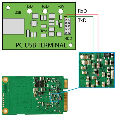

Suddenly i have started to receive SSD cases ,earlier it was just HDD and occasional SSD's . I have received a Samsung PM851 MSATA .There is a acelab blog for this -> http://blog.acelaboratory.com/pc-3000-s ... minal.html "Blocked for Normal Users ,Only for Acelab Customers " . They seem to support this CPU " S4LN045X01-8030 " .

Well after reading that article on the acelab blog i think this is safe mode points and terminal connections . My circuit is a little different but this is what i think are safe mode test points and terminal connection pads " The coating of terminal connection needs to be removed and wire has to be soldered there " .Please Click on Photo Below To See it In Larger Domain

My understanding is that the two pads closest to the centre of the PCB are the safe mode shorting points. The mSATA PCB doesn't expose the terminal pins, so that's why Ace doesn't support this form factor. At least that was the case the last time I looked.

Amarbir[CDR-Labs] wrote: My circuit is a little different but this is what i think are safe mode test points and terminal connection pads
From my understanding you have both pairs of correct pads identified but the functionality flipped.

fzabkar wrote:My understanding is that the two pads closest to the centre of the PCB are the safe mode shorting points. The mSATA PCB doesn't expose the terminal pins, so that's why Ace doesn't support this form factor. At least that was the case the last time I looked.
Well,
Acelab does support mSATA form factor ,And they have clearly marked the pads for safe mode access in thier blog.The Terminal pins in mSATA interface has a via on component side masked not exposed ,Hence you need to scratch those VIAS to get terminal access .Terminal access is required to work with this SSD due to the fact ATA Section gets blocked when SSD enters Busy mode .
I assume your pc3K support has expired, does your version of pc3k cover these, otherwise I'm curious on how you're going to proceed.
Well,
I am very sure my findings and pads identification is bang on .Very earliest PC3K versions with SSD support do support these SSD ,I am going to proceed with my brain not acelabs brain ,Only thing i use is thier tool .Infact since many years i have never taken acelab support .We in India these days live on cutting edge tools and technology .

Aces red/blue colour scheme reverse half way into the article and there doesn't appear to be anything specific for that drive page. I assume as you had the drive in front of you, that you actually checked it :D

To work with this drive, you must use the 840 EVO utility.
