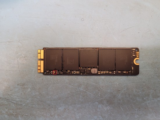

Hello all,
I'm in need of some assistance with my SSD in the subject.
I saw a damaged capacitor (highlighted in red) , I tried to replace it but nothing changed.
Has anyone had a similar experience or know of a potential solution?
I've tried doing some research on my own, but I'm not really sure what the best course of action is. Any help would be greatly appreciated!
Thanks in advance.
Re: Apple SSD Toshiba 656-0021B dead
January 11th, 2023, 12:31
Are you able to access both sides of the SSD in a powered state? If so I could help you to measure the voltage test points.

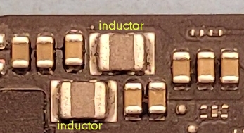

January 13th, 2023, 4:15
here the other side of the board.

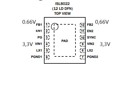

January 13th, 2023, 6:00
n3dv3d wrote:The value of R47<->GND is 1,14V
Attached measures of 8022 and 8025A
January 13th, 2023, 13:04
I expect they will be OK, but these are the other two supply voltages. Measure the voltage between each inductor and ground.

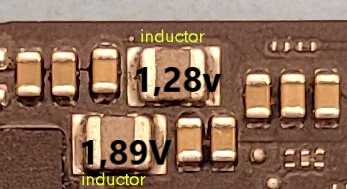

January 16th, 2023, 5:31
here the measure of inductors. Is it correct?
January 16th, 2023, 13:24
Those supplies look OK. The other tiny components could be load switches, in which case we should check their outputs. Unfortunately I can't discern their part markings, so I can't be of any more help.
