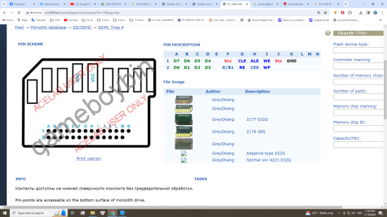

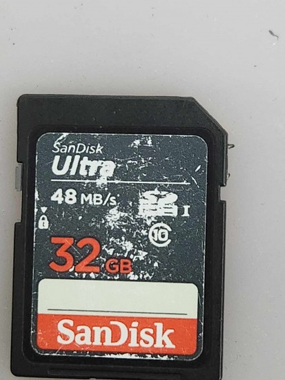

So i am having this Sandisk 32gb 48mb/s SD card
I used Type 4 Pinout from Acelabs Solbase

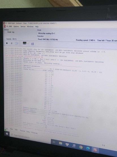

Got the card to ID but i think it did not id correctly
It ID: 45 3e 96 93 (64gb)
Which is a 64gb SD
Can anyone check if i got the correct pinout???
Or can someone provide a pinout for me
Many Thanks!!!
Pin
SD card
Acelab Layout

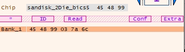

Here is the ID of PC3000 Flash
ID

Start direct reading mode and see what is in the second half of the dump.

Do not doubt, the pinout and chip configuration are entirely accurate. Genuine SanDisk USB drives and SD cards may also undergo production methods that reduce capacity, just like refurbished products, although this is rare.
The chip is labeled as 128GB, but the actual capacity is 256GB
