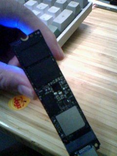

I got this 970 Evo plus Samsung NVME SSD
Screenshot 2026-03-15 232347.png (60.59 KiB) Viewed 2302 times
I have measured some capacitors. None of them gives any voltages

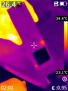

Upon Heat inspection the only chip that have a slight temperature is this AtAYF chip
The drive consuming 0.1A
Thanks for helping me out!

"AtAYF" is an e-fuse. There should be 3.3V at Vin and Vout.
https://www.hddoracle.com/viewtopic.php?p=8872#p8872
I expect that its pinout would be similar to STEF05:
https://www.hddoracle.com/download/file.php?id=3096&mode=view
Re: Samsung 970 Evo Plus 500GB no power
March 15th, 2026, 15:59
fzabkar wrote:I expect that its pinout would be similar to STEF05:
Perhaps it's similar to STEF4S rather than STEF05.
March 21st, 2026, 7:13
So i managed to fix the drive. The problem was the Power IC S2FPS05A01. After swapping the chip. The drive started working again
