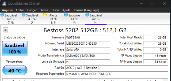

I have 2 SSD m2 ngff from Bestoss and from one day to the next it went into Rom mode.
I'm trying to find the correct MPTool to try to recover but so far without success. I'll leave some information about the bad and good SSD, if anyone can help I'd be grateful.
v0.569a
Drive: 4(ATA)
OS: 10.0 build 26200
Model: SM59XT2A-10-00831001
Fw : 20210308
Size : 0 MB [0.0 GB]
Controller : SM2259XA (SM2259XT2) in ROM Mode
Bank00: 0x2c,0xd3,0x1c,0x32,0xc6,0x0,0x0,0x0 - Micron 96L(N28A) QLC 1024Gb/CE 1024Gb/die
Bank01: 0x2c,0xd3,0x1c,0x32,0xc6,0x0,0x0,0x0 - Micron 96L(N28A) QLC 1024Gb/CE 1024Gb/die
Bank04: 0x2c,0xd3,0x1c,0x32,0xc6,0x0,0x0,0x0 - Micron 96L(N28A) QLC 1024Gb/CE 1024Gb/die
Bank05: 0x2c,0xd3,0x1c,0x32,0xc6,0x0,0x0,0x0 - Micron 96L(N28A) QLC 1024Gb/CE 1024Gb/die
v0.569a
Drive: 3(ATA)
Model: Bestoss S202 512GB
Fw : W0724A0
Size : 488386 MB [512.1 GB]
From smart : [SMI2259XT] [W0724A0 00] [N2800]
Controller : SM2259XA (SM2259XT2) bufferless
FlashID: 0x2c,0xd3,0x1c,0x32,0xc6,0x0,0x0,0x0 - Micron 96L(N28A) QLC 1024Gb/CE 1024Gb/die
Channel: 2
CE : 2
TotDie : 4
Plane : 4
Die/Ce : 1
Ch map : 0x03
CE map : 0x05
Inter. : 2
First Fblock : 2
Total Fblock : 492
Total Hblock : 7632
Fblock Per Ce : 492
Fblock Per Die: 492
Original Spare Block Count : 40
Vendor Marked Bad Block : 0
Bad Block From Pretest : 6

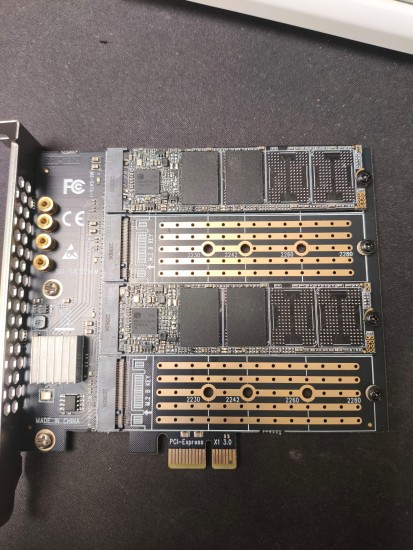

I need to repair an SSD that is stuck in ROM mode.
The files on it aren't important.
I tried using MPtool, but the program doesn't recognize either the faulty SSD or the working one.
Re: Help to recover bestoss ssd in Rom mode
July 22nd, 2026, 7:27
skilllow wrote:I need to repair an SSD that is stuck in ROM mode.
Maybe you need a USB-NVME adapter? As far as I remember, that's the only way to use a SATA-SSD.
