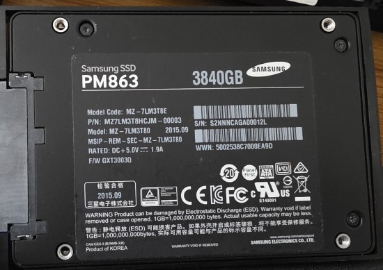

Hello everyone,
Hope you are doing well. I have two 3.84TB Samsung PM863 SATA SSD that I purchased about 10 years ago. I bought them from a website (new), so they are not from Dell/HP etc.
There were some file corruptions, and I think that it could be due to an early bug these SSDs had. My SSD firmware is very old: GXT3003Q. I was wondering if anyone have any later firmware that I can flash my SSDs with.
I've attached an image of one of the SSDs, just in case if it helps.
I found and updated firmware from the amazing repository I found on hddguru, but sadly no firmware for PM863 (Non-A)
Please help. Many thanks in advance.

There are several Dell OEM PM863 updates in this repository:
https://github.com/ItsMly/ssd-firmware/tree/main
The .txt files describe the issues that were addressed by each update. You can decide if they were important. I expect there would have been a corresponding generic version for each update.

Thank you. Will they work on my SSD? Mine is not a Dell Part. It is OEM Samsung.
Re: Looking for Samsung PM863 3.84TB firmware. Please help.
October 6th, 2026, 18:31
I wouldn't use those Dell updates. I would just read the changelog to see what issues were addressed. Then you could decide if those issues are important to you. AFAICT, none was flagged as urgent, but ISTR that one Samsung model was affected by a 40000 hours bug.
