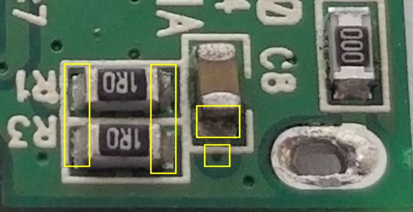

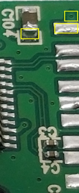

jeremyb wrote:
ddrecovery wrote:
4.3v, not sure why its not 5v.
That's not good, try taking the DC/DC converter out of the circuit. Something is pulling amperage.
Pulled the converter but it had no effect on voltages at C8 and C104
jeremyb wrote:
Tim what model controller does this flash drive have?
Phison 2251 and yes it is BGA.

 Post subject: Re: Flash Drive Help
PostPosted: June 4th, 2018, 18:58
Posts: 17341
AFAICT, +5V should be present at each of the marked test points.

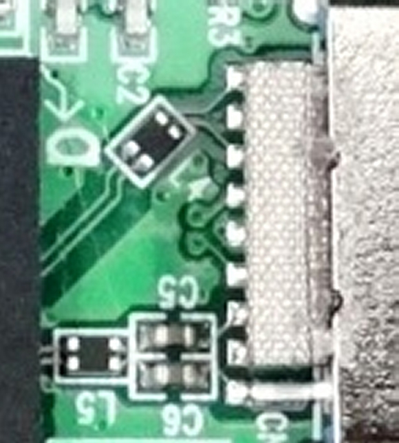

PostPosted: June 4th, 2018, 19:35
Joined: July 30th, 2012, 3:37
Posts: 314
Location: Fairfield, CT USA
Use a USB 2.0 connector and see what happens, looks like it bypasses all the circuitry and goes directly into the controller.

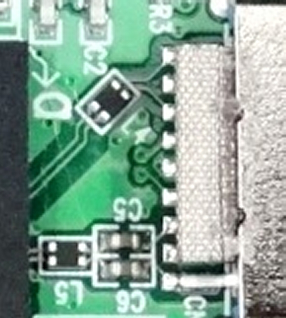

PostPosted: June 4th, 2018, 19:36
Posts: 17341
This one has a different USB pinout, plus it has two switchmode regulators:
http://thessdreviewcdn2.thessdreview1.netdna-cdn.com/wp-content/uploads/2013/05/Patriot-256GB-Flash-Drive-PCB-Front.jpg
Ouch!
PostPosted: June 4th, 2018, 19:39
Posts: 314
No Seriously, I do this all the time, the tx speed is slow as fuck but it legit works, this is how USB 3.0 ports are wired...
If your nervous use a resettable fuse from a SanDisk flash drive like I outline in my monolithic video between +5v and your voltage source..
No it doesn't look closer
Recover My Flash Drive
PostPosted: June 4th, 2018, 19:54
Posts: 17341
Sorry, they still look different to me. :?
PostPosted: June 4th, 2018, 19:59
Posts: 17341
jeremyb wrote:
:shock: :shock: :shock:
Lol, but you can see it yourself..
USB 2.0 connector pins are interleaved with USB 3.0. This is a fact, I know, I work with them frequently. Recover My Flash Drive :lol: :lol:
Look at his picture, +5v USB 2.0 bypasses all the circuitry and goes directly into the controller. his picture is missing the via's for D+ and D-, but your picture has them..
USB 2.0 GND is on that tiny capacitor.
Some InnoStar controllers do the same thing, they isolate USB 2.0 from USB 3.0
You are telling the OP to connect USB ground to a USB 3.0 signal pin, and USB +5V to another USB 3.0 signal pin. That's absurd.
