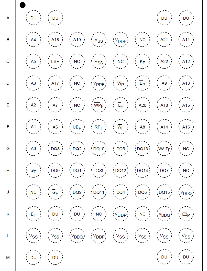

I have this chip from a very old Motorola V3 phone. Its only 512MB but has some critical photos we need to recovery. This chip is a multi-chip package and I am having difficulty working out the correct pinout for the flash memory side. I have attached an image of the pinout as well as the datasheet. If any of you flash gurus can help it would be much appreciated.

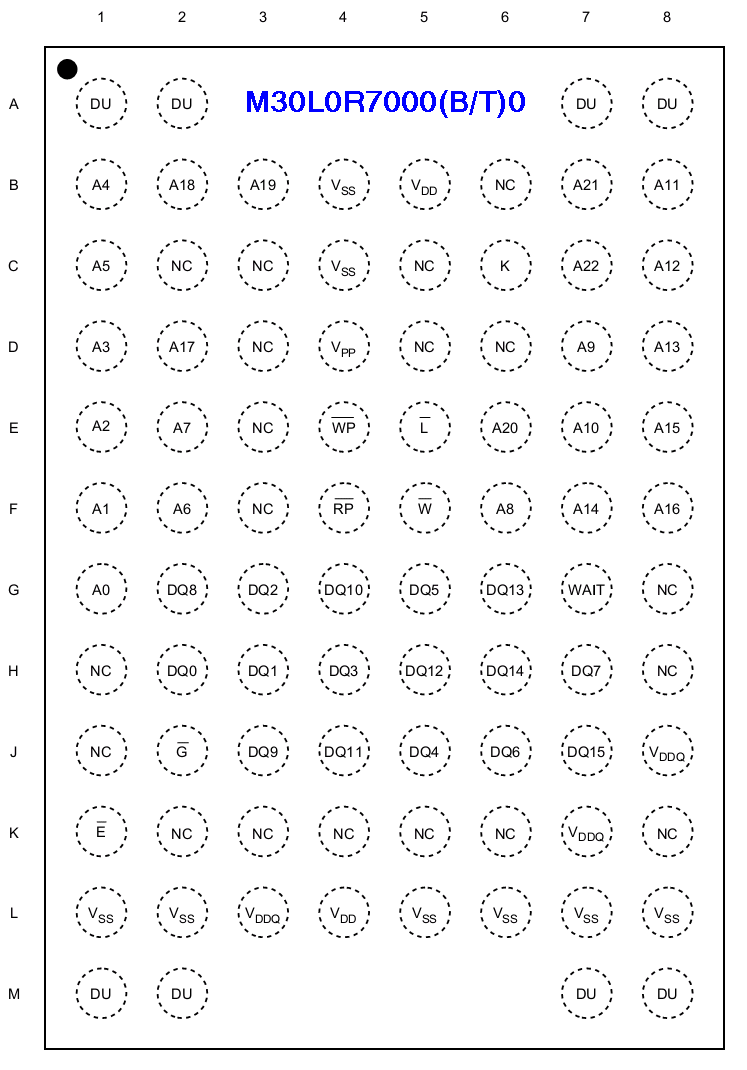

Your multi-chip appears to be ball compatible with the M30L0R7000B0 flash-only chip. That is, the RAM balls are not connected (!). However, the "multi" datasheet stipulates that the RAM's output must be disabled to avoid contention on the data bus. I don't know if this still applies if the RAM's power supply is not present (I suspect not).
Simply put, if you have an adapter for the M30L0R7000B0, or similar, then it should work.
M30L0R7000(B/T)0, STMicroelectronics, 128 Mbit (8Mb x16), Multiple Bank, Multi-Level, Burst, 1.8V, Flash Memory :
http://pdf.datasheetcatalog.com/datasheet2/0/01rzqfgx971prpsrg57cw4tzaqwy.pdf

Unfortunately there are no adapters for this particular chip (probably not popular enough), so I trying to do it the hard way. There are pins that I do not recognize such as DU and G and E.
DU = do not use
E* = Chip Enable (must be low to enable chip)
G*= Output Enable (must be low to enable output when reading)
All the pins are defined in the datasheet.

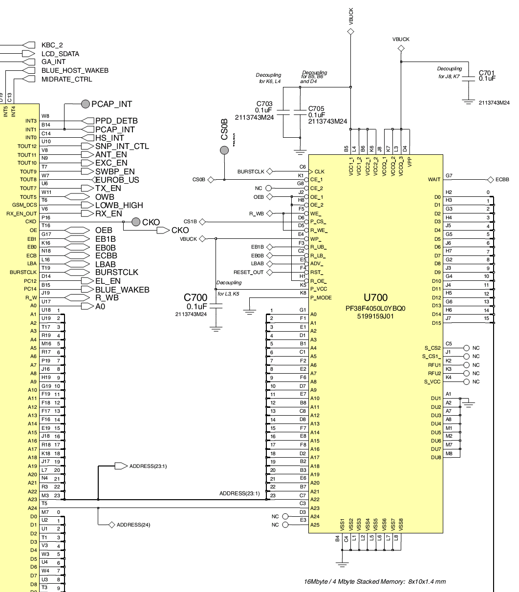

FYI, here are the circuit diagrams and repair guides for a Motorola RAZR V3:
https://elektrotanya.com/showresult?what=razr%20v3&kategoria=&kat2=all
https://elektrotanya.com/motorola_razr_v3.rar/download.html
https://elektrotanya.com/motorola_razr_v3_sm.pdf/download.html
BTW, the chip's capacity is 16MB flash + 4MB SRAM, not 512MB.
The chip in the circuit diagram is a PF38F4050L0YBQ0.
