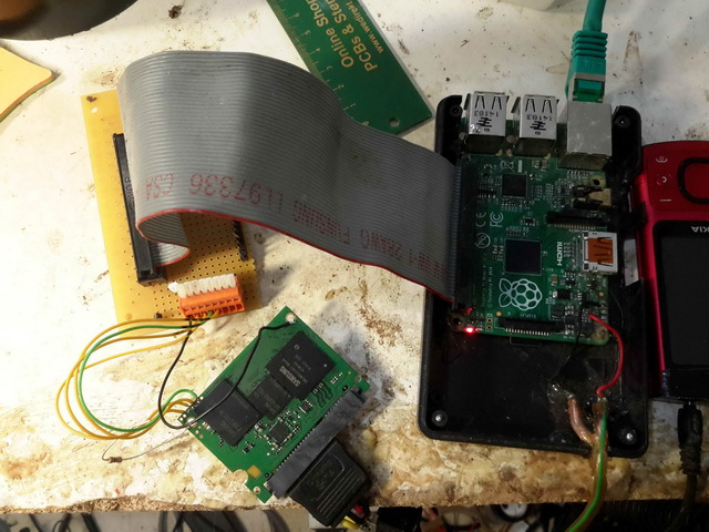

I am also JTAGGING an PM851 now since it's firmware maybe affected by a pretty resistant rootkit.
The MEX-script did not work with latest OpenOCD (I am using a Raspberry PI as the interface).
debugging it works nice after changing the script to
source [find interface/raspberrypi-native.cfg]
transport select jtag
adapter_khz 100
reset_config none
# enable tcl_port of course when using the scripts
# currently just connected using telnet
tcl_port disabled
#jtag newtap auto0 tap -irlen 1 -expected-id 0x25966f0f
jtag newtap auto0 tap -irlen 4 -expected-id 0x4ba00477
dap create mydap -chain-position auto0.tap
target create mex1 cortex_r4 -dap mydap -coreid 0
target create mex2 cortex_r4 -dap mydap -coreid 1 -dbgbase 0x80002000
target create mex3 cortex_r4 -dap mydap -coreid 2 -dbgbase 0x80003000
init
targets
halt
btw the connector is 4-Pin JTAG only. There is NO sRST or tRST available
Looks like it uses other memory regions. I cannot dump 0x8A0000 for example but having lot other readable regions.
I will check the dumps now and try to find the proper regions.
Would be nice to have a genuine firmware image for PM851

 Post subject: Re: Samsung SSD Failed Controller - Options?
PostPosted: November 28th, 2018, 12:47
Joined: November 27th, 2018, 16:42
Posts: 5
Location: Greece, Amaliada
The 1MB-Files from SAMSUNG are XORED
Looks like the FW itself is in a serial flash on the backside.
I guess the 128KB at address 0 is a bootloader.
JTAG works stable up to about 400kHz
PostPosted: November 28th, 2018, 13:55
Posts: 5
ahhh - "Temperature sensor" - NOT Flash.... Finally found the "lost manual".
Also found the de-obfuscator. So not just a simple XOR. Looked to me like that because of all those "0x10"
Hmmm - but where is firmware located within the chip?
PostPosted: November 28th, 2018, 14:52
Posts: 17256
This?
SSD firmware hacking:
http://forum.hddguru.com/viewtopic.php?f=13&t=31127
PostPosted: November 28th, 2018, 18:06
Posts: 5
Yes. I compiled the version from GITHUB. Found that link in the "MissingManual".
https://raw.githubusercontent.com/ddcc/ ... /samsung.c
I found two firmware-Versions in the internet:
EXT49D0Q and EXT08D0Q but it looks like I have an earlier one.
0x5c000 from the image is mapped to 0 in then Controllers addressspace but starts to differ (a little bit) from about 0xba0. The latest version differs most.
I am no expert in multi-core controllers as well as no ARM expert.. Maybe I am one when finished this :-)
