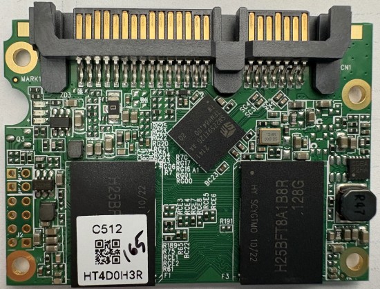

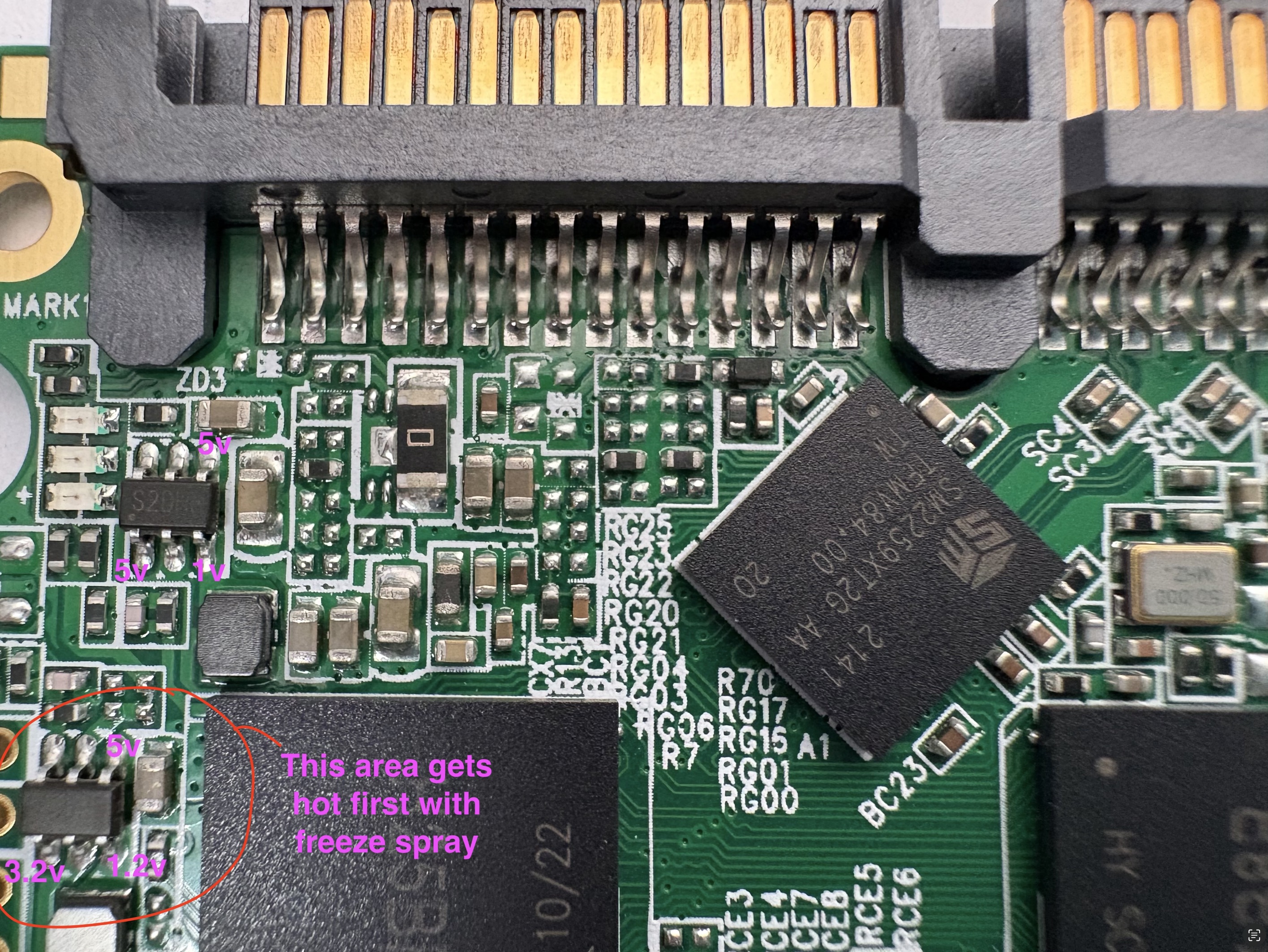

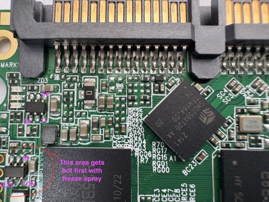

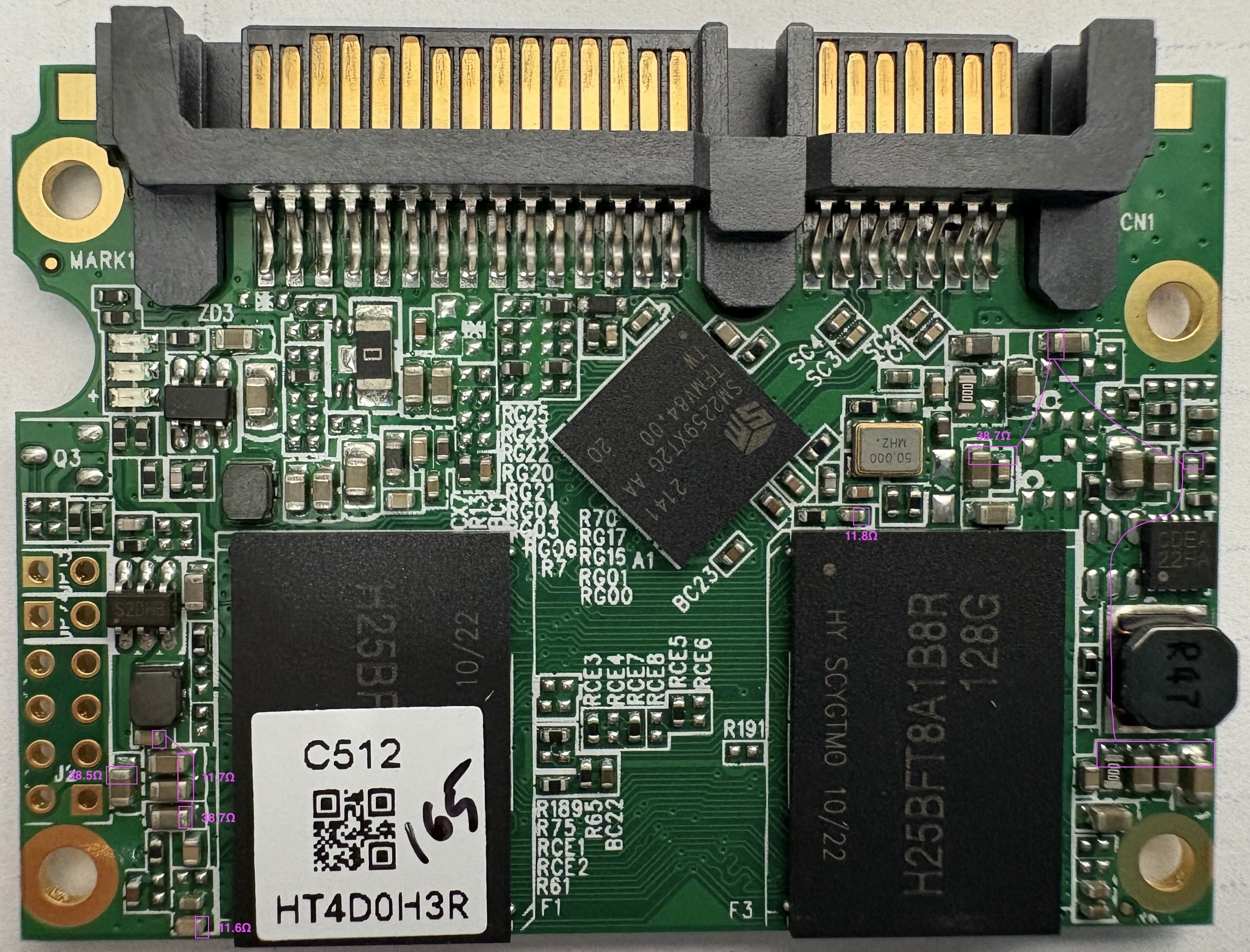

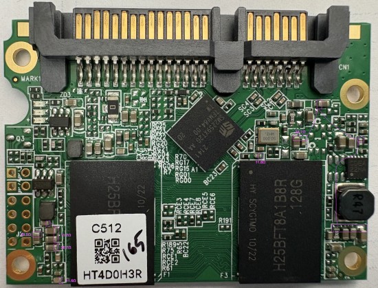

Hi everyone. I have this SSD which has got me stumped. It shows no output to the registers when connected to power. I first suspected one of these S2DHB (voltage converters?) but I don't know. I don't have a good one of these to compare, so I'm unsure if I'm missing anything obvious.
I tried a quick check for a short with freeze spray and the lower S2DHB warmed up pretty quick, but it doesn't seem shorted.
File comment: voltage measurements
File comment: pcb full view

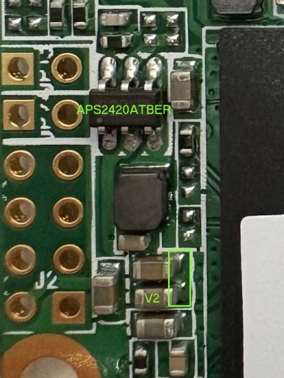

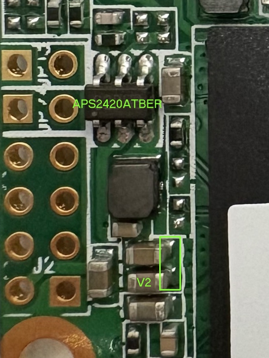

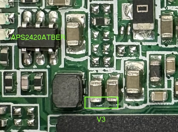

APS2420ATBER, Chipown, Synchronous buck regulator, 1MHz,2.0A, 2.5V - 6.5Vin, marking S2xyp, SOT-23-5L:
https://images.chipyun.com/pdf/C130331_1505703382114975241.pdf
Measure the resistance between pin #3 and ground.

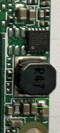

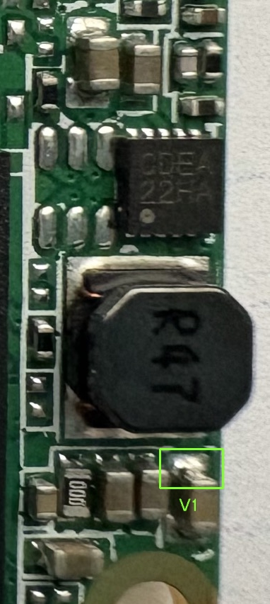

What is the output voltage at the large inductor at the right hand side of the PCB?

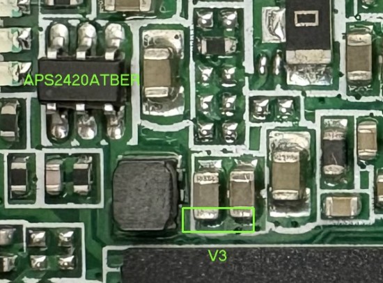

V1, V2, V3 would be the supply voltages.

My notes ...
marking CDEA, DFN-10
https://vlab.su/viewtopic.php?f=49&t=132789
unknown - CDEA-DFN10, can stand with 2R2, R47 chokes, usually makes 3.3V power (4-EN 6-FB)
It turns out CDEA
1, 2, 3 throttle output. ---> Lx ? (FZ)
4 - EN 5 volts.
5- through a 148 kΩ resistor with 5 volts, on the leg 4.7 V.
6-FB through a divider, one 270 kΩ, to the ground 59 kΩ. ---> feedback ref must be 0.6V (FZ)
7- on the capacitor (maybe somewhere else)
8- through a 10 ohm resistor with 5 volts.
9, 10 - input 5 volts.
There is no short-circuit, it seems that everything is at the output of 0.3 volts.

Here's what I've got so far. Apologies if I've missed anything, that was a lot of info!
Top S2xxx chip PIN 3 --> GND == OL
Bottom S2xxx chip PIN 3 --> GND == 11.7Ω
V1 == 3.29v
V2 == 1.24v
V3 == 0.93v
Large inductor near V1 == 3.20v
CDEA
1,2,3 == 3.19v
4 == 5.02v
5 == 5.05v
6 == 0.59v
7 == 0v GND?
8 == 5.10v
9 == 5.10v
10 == 5.10v
 Post subject: Re: Netac SSD SM2259XT2G
PostPosted: February 26th, 2025, 17:37
Posts: 17228
It does look like whatever is being powered by the "Bottom S2xxx chip" is overloading the supply. I think the chip is OK, and the output voltage seems plausible.
I would think that if one of the capacitors is leaky, it shouldn't stop the SSD from working as long as the supply is OK. Instead, I would suspect one of the major ICs. You now need to determine if any of the capacitors around the NANDs measure 11 ohms. If so, then it could be the NAND itself which is bad. Otherwise, look for an 11-ohm capacitor around the controller.
Is one NAND warmer than the other?
Is it possible that there are two problems? A leaky capacitor may have gone unnoticed for a long time, but an unrelated firmware problem may have developed more recently.

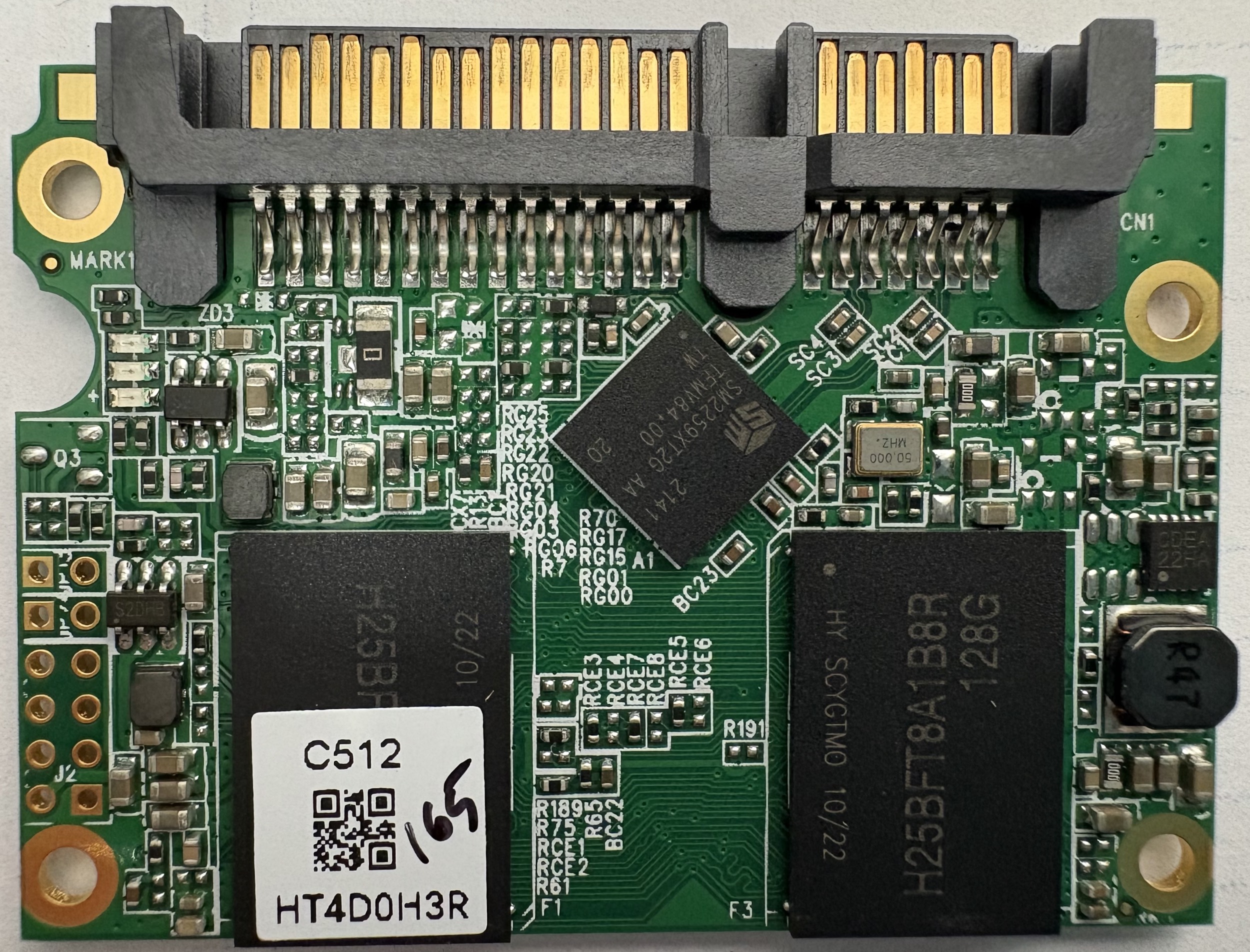

I measured a bunch of caps around the NANDs so here's a photo of that. Nothing gets noticeably hotter than anything else, although the whole board does get a bit warm when powered up for a short while. The 37ohm ones seem to be on the 3.3v side.
Drive does not ID when shorted for safe mode, so I don't think it has a firmware problem?

Check the FB (feedback) pin of the converter IC. It should be 0.6V when the IC is regulating at the correct output voltage.
PostPosted: February 28th, 2025, 6:05
Joined: February 25th, 2025, 11:15
Posts: 8
Location: Englang
Yes, on CDEA chip, Pin 6 == 0.59v
PostPosted: February 28th, 2025, 9:09
Posts: 8
Location: Englang
Not sure what happened but my reply went to moderator. Yes, Pin-6 on CDEA chip shows 0.59v
PostPosted: February 28th, 2025, 11:28
Posts: 17228
I was thinking of the "hot" converter.
PostPosted: March 3rd, 2025, 7:08
Posts: 8
Location: Englang
Ah yes, apologies. Yes, both those two S2 ICs show 0.6v on pin 6 too.

Hello together,
i have a Verbatim Vi550 512GB, with the same controller, similar layout, almost the same behavior, except it doesn't heat up.
It draws almost constantly between 100 and 110 mA , no obvious sign of life, no status on SATA register (BSY or RDY ), all the voltages are looking good, 3.3V, 1.8V, 0.9V, undetected, including ROM mode is not working.
Something strange for me, is that on pin 1 and 2 (connected together) on SATA connector but also on pin 3, the SSD returns 3.3V. I wonder why? And what could this mean? I'm also looking for a donor for comparison.
