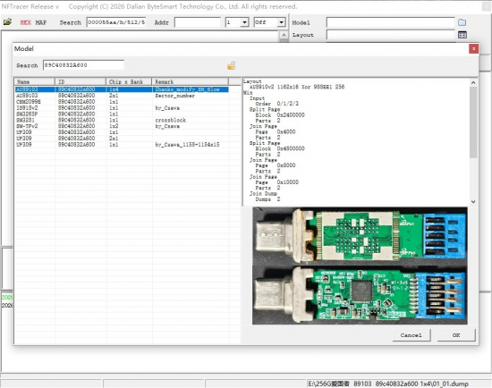

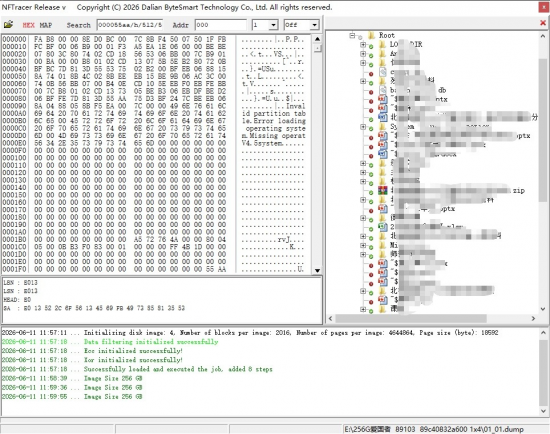

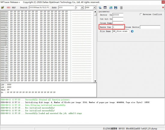

 Post subject: Sector Sorting with Multi-BANK Support by NFT
PostPosted: Today, 3:37
Joined: April 9th, 2026, 0:03
Posts: 10
Location: china
When performing data reorganization on the AU89103 chip and subsequent sector sorting, nearly half of the files and directories failed to be parsed correctly.
After investigation, we confirmed that BANK differentiation is required during the sorting process.
Since many similar chips have the same issue, we have added multi-BANK analysis to the sector sorting module of NFT to resolve this problem.
1.png [ 531.04 KiB | Viewed 57 times ]
2.png [ 460.6 KiB | Viewed 57 times ]
3.png [ 677.01 KiB | Viewed 57 times ]
website: https://www.flash-tracer.com/
