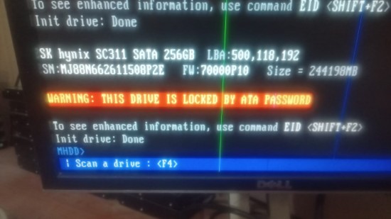

 Post subject: sk hynix password locked
PostPosted: Today, 6:08
Posts: 146
Location: Karachi
hi
can someone help
for removing password
WhatsApp Image 2026-05-17 at 3.45.18 PM.jpeg
WhatsApp Image 2026-05-17 at 3.45.18 PM.jpeg [ 92.8 KiB | Viewed 93 times ]
 Post subject: Re: sk hynix password locked
PostPosted: Today, 11:11
Posts: 119
Location: Canada
You need the password as the ATA6 standard requires it to enable use of the storage device. This applies to NVMe as well.
Orico DS500C3-US-BK 5-disk 3.5" SATA, iTGZ 4x M.2 2280 Thunderbolt enclosure NVMe/SATA, etc. etc.
