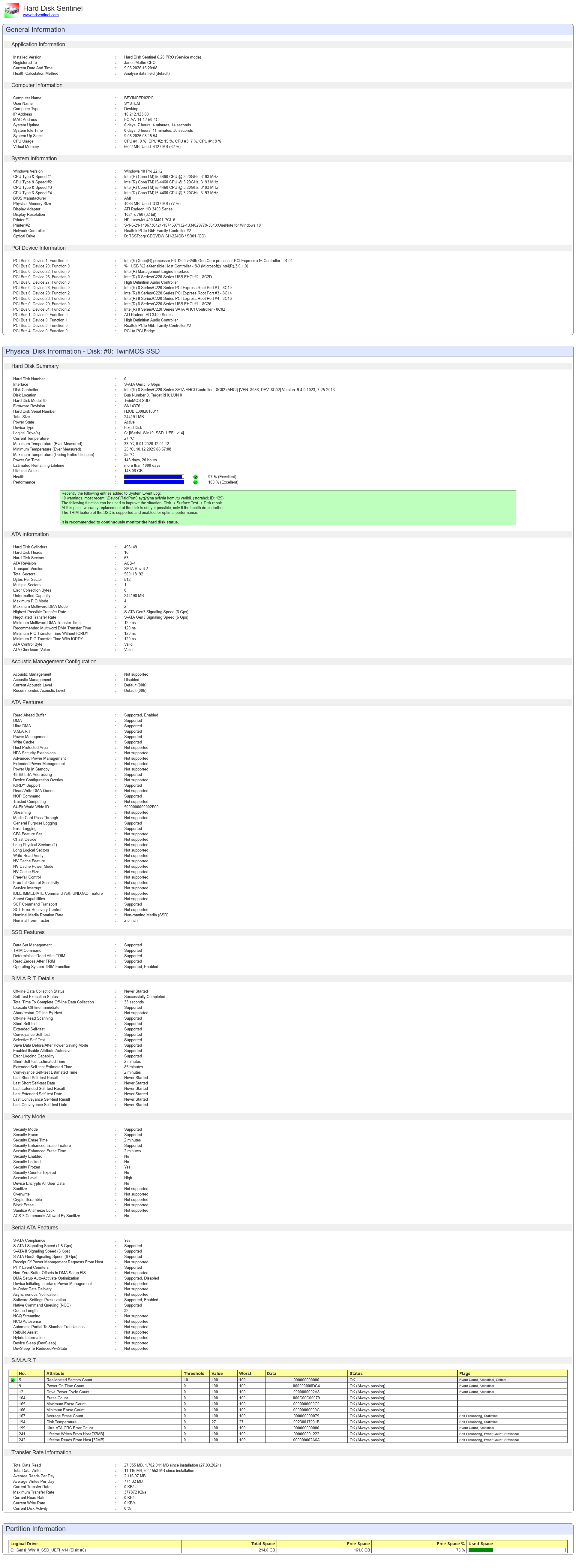

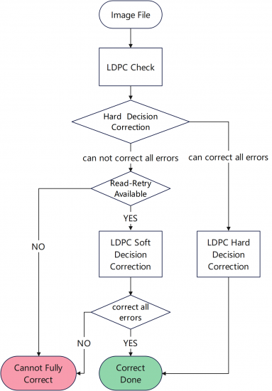

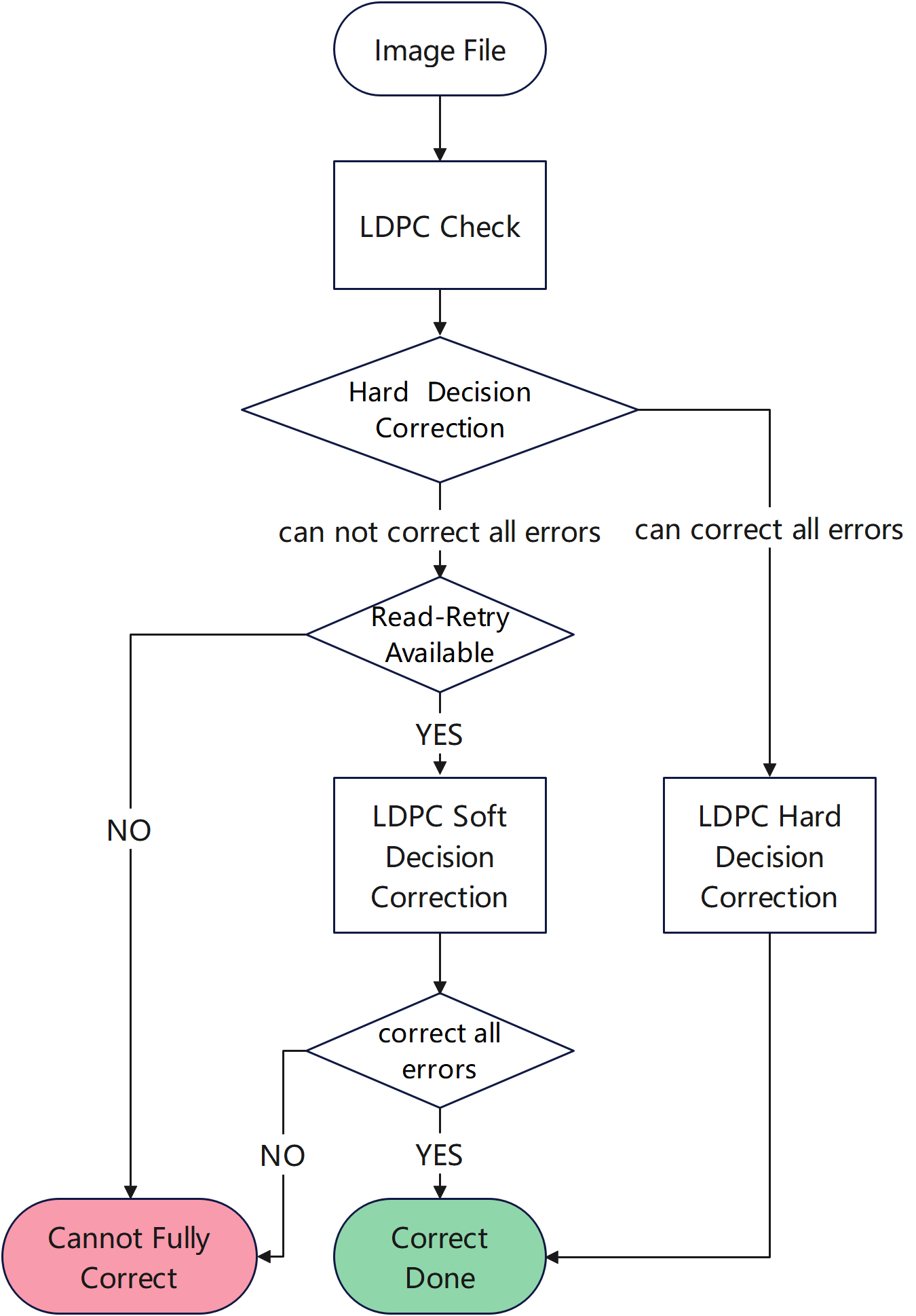

1. Import or read raw flash image files and initiate basic LDPC parity check.
2. Prioritize high-speed hard decision decoding: fast iterative bit flipping based purely on binary 0/1 values.
Pages with low bit error rates can be corrected with one click, delivering fast decoding speed and high efficiency for batch processing.
3. If hard decision decoding fails to correct all errors, read chip data via multiple read-retry schemes to generate soft decision dependency files.
4. Launch in-depth soft decision decoding: leveraging confidence data from voltage intervals to accurately identify ambiguous bits
caused by threshold drift and charge loss, greatly boosting extreme error correction performance.
5. Verify page integrity after two rounds of decoding. A clean image will be exported once all errors are corrected.

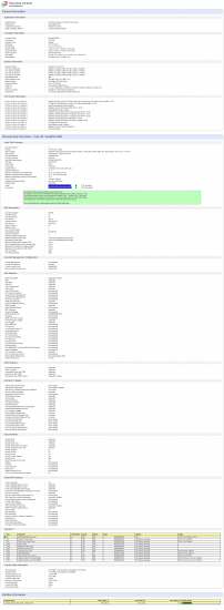

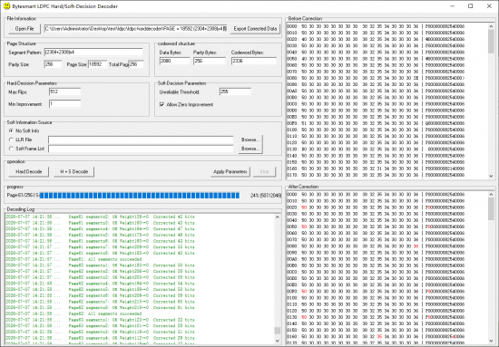

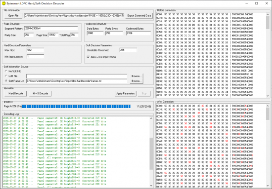

Hard-Decision Correction Result

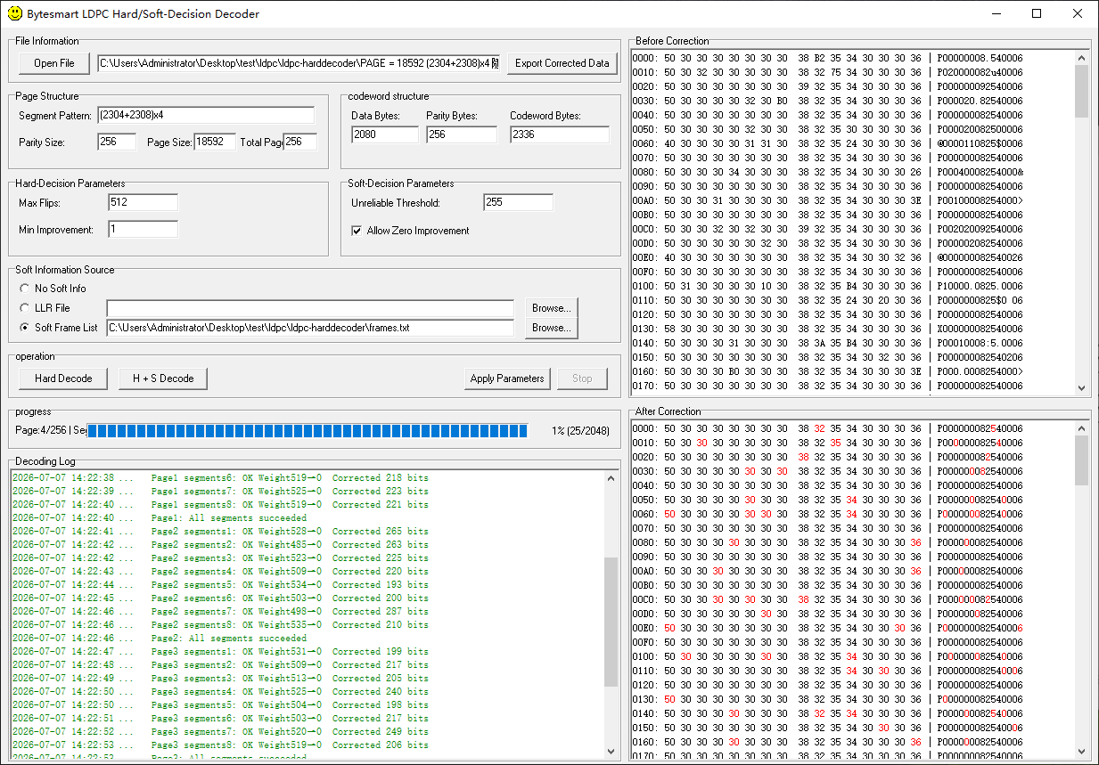

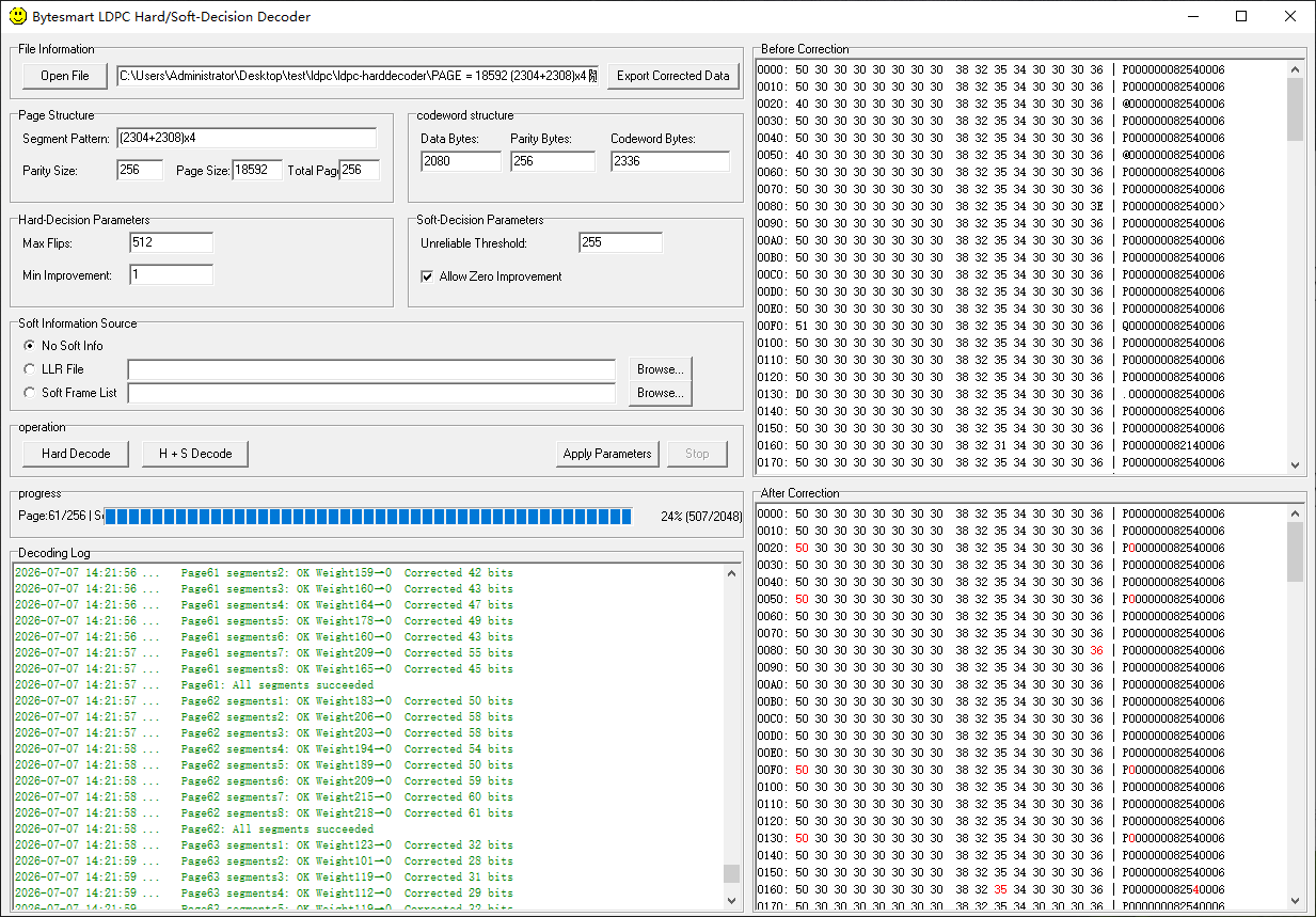

Soft-Decision Correction Result
