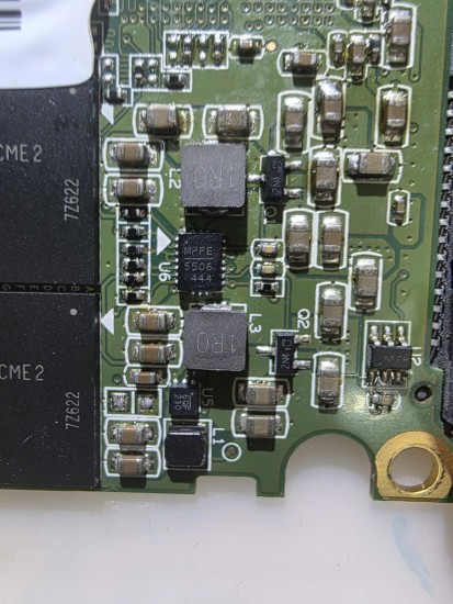

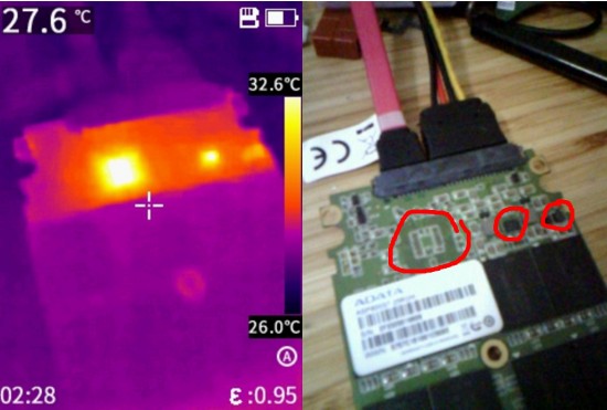

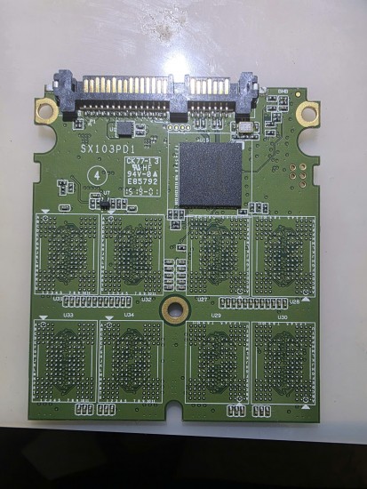

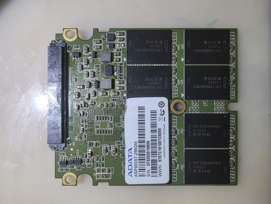

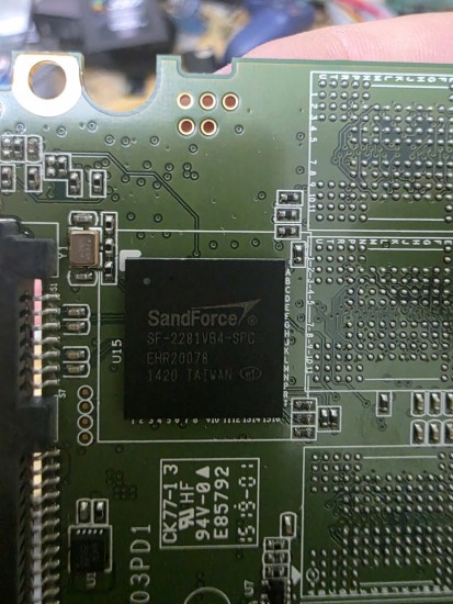

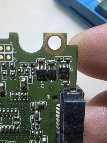

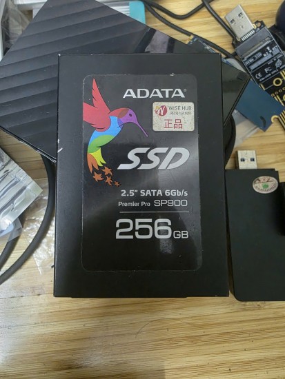

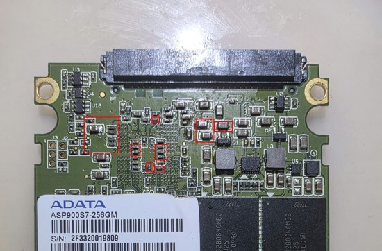

 Post subject: ADATA Premier Pro SP900 shorting everywhere
PostPosted: Yesterday, 14:40
Posts: 222
Location: Vietnam
Need your guys help!
I have this SSD ADATA SP900, It is shorting everywhere. By getting to ROM mode. Controller works fine (Sandforce SF-2281VB4-SPC).
Can anyone provide measurements for the drive. And what can be faulty?
Many thanks!
ADATA SP900
1 SSD.jpg
1 SSD.jpg [ 547.69 KiB | Viewed 248 times ]
FRONT
2 FRONT.jpg
2 FRONT.jpg [ 831.81 KiB | Viewed 248 times ]
BACK
3 BACK.jpg
3 BACK.jpg [ 1 MiB | Viewed 248 times ]
CONTROLLER
4 CONTROLLER.jpg
4 CONTROLLER.jpg [ 649.33 KiB | Viewed 248 times ]
RIGHT SIDE ZOOM
5 FUSE SIDE.jpg
5 FUSE SIDE.jpg [ 724.87 KiB | Viewed 248 times ]
LEFT SIDE ZOOM
6 LEFT SIDE.jpg
6 LEFT SIDE.jpg [ 742.57 KiB | Viewed 248 times ]
HEAT
HHH.jpg [ 202.28 KiB | Viewed 248 times ]
Shorting points
SHORTING POINTS.jpg
SHORTING POINTS.jpg [ 1.39 MiB | Viewed 248 times ]
 Post subject: Re: ADATA Premier Pro SP900 shorting everywhere
PostPosted: Today, 7:45
Posts: 222
Location: Vietnam
Can anyone help me out!
 Post subject: Re: ADATA Premier Pro SP900 shorting everywhere
PostPosted: 13 minutes ago
Posts: 17025
Examine the terminal log.
It's obviously not "shorting everywhere".
https://northwind.gr/en/data-recovery-from-ssd-drives/data-recovery-from-sandforce-ssds/
Users browsing this forum: No registered users and 32 guests
