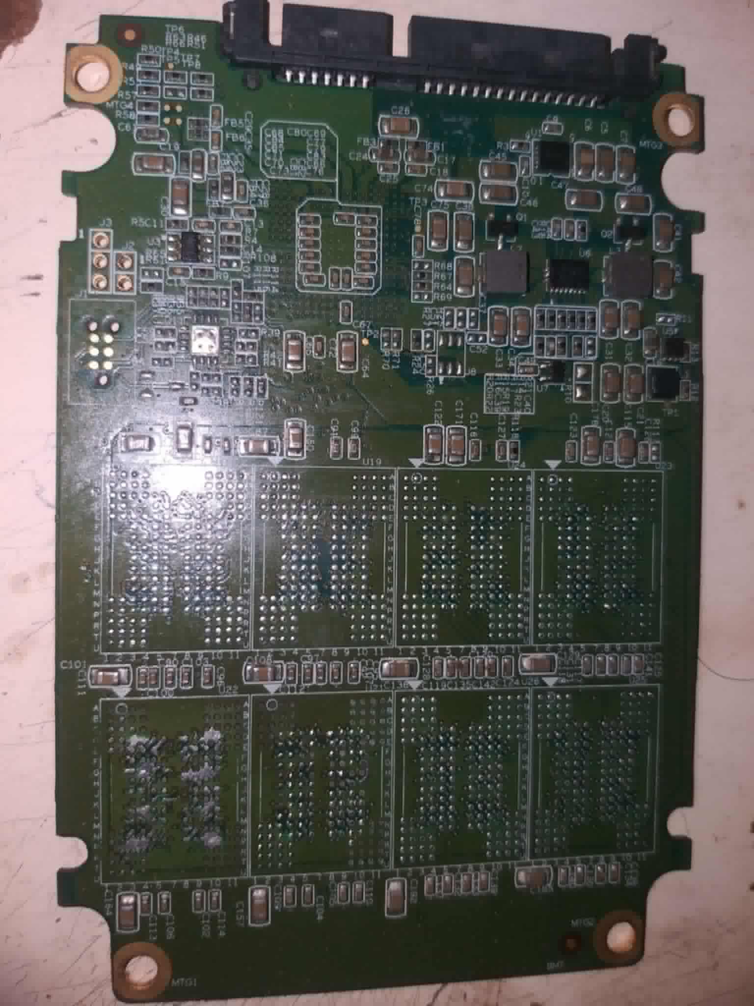

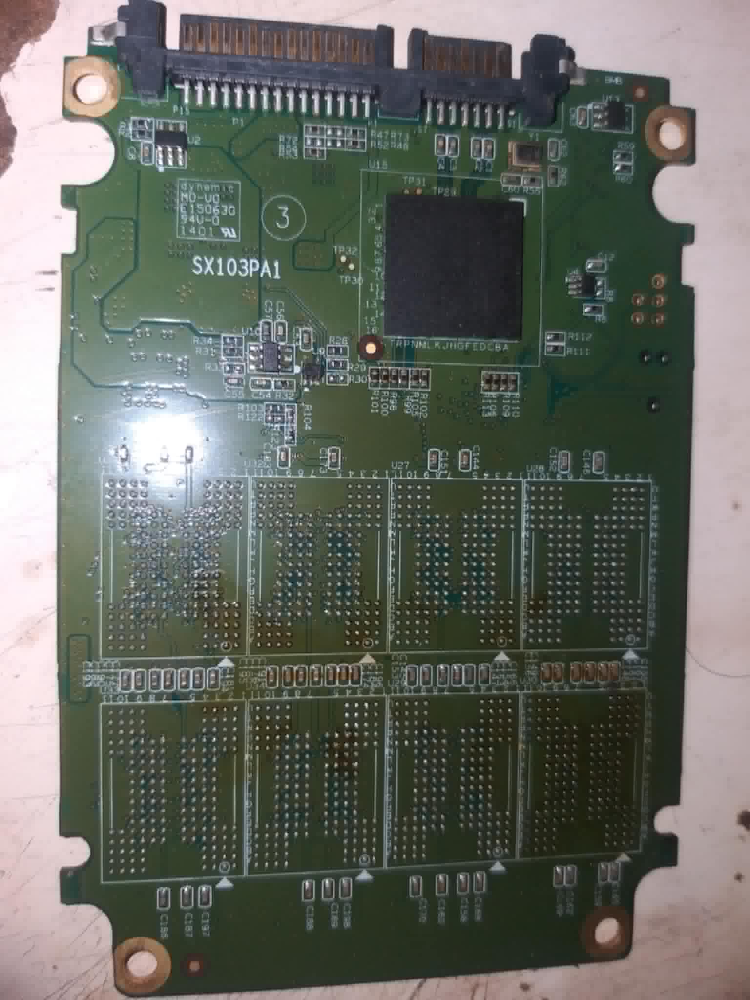

Post new topic Reply to topic  [ 40 posts ]  Go to page Previous  1, 2
 Post subject: Re: ADATA Premier Pro SP900 shorting everywhere
PostPosted: July 9th, 2026, 19:03
Posts: 238
Location: Vietnam
A Vcore voltage of 1V is OK, as I understand it. The supply voltage seems unaffected by the low resistance. I just don't understand why your two Vcore resistance readings differ.
What can a half bad resistor do?? I mean something is definitelly affecting the Vcore resistance at the resistors
 Post subject: Re: ADATA Premier Pro SP900 shorting everywhere
PostPosted: July 10th, 2026, 10:14
Posts: 17051
gameboybin wrote:
A Vcore voltage of 1V is OK, as I understand it. The supply voltage seems unaffected by the low resistance. I just don't understand why your two Vcore resistance readings differ.
What can a half bad resistor do?? I mean something is definitelly affecting the Vcore resistance at the resistors
Measure the resistance between the L2 inductor and your "shorted" capacitors. Is it 0 ohms?
 Post subject: Re: ADATA Premier Pro SP900 shorting everywhere
PostPosted: July 10th, 2026, 15:15
Posts: 238
Location: Vietnam
gameboybin wrote:
A Vcore voltage of 1V is OK, as I understand it. The supply voltage seems unaffected by the low resistance. I just don't understand why your two Vcore resistance readings differ.
What can a half bad resistor do?? I mean something is definitelly affecting the Vcore resistance at the resistors
Measure the resistance between the L2 inductor and your "shorted" capacitors. Is it 0 ohms?
They have from 190 to 220 ohms
SHORTING POINTS 200.JPG
SHORTING POINTS 200.JPG [ 555.83 KiB | Viewed 1742 times ]
 Post subject: Re: ADATA Premier Pro SP900 shorting everywhere
PostPosted: July 10th, 2026, 15:32
Posts: 238
Location: Vietnam
gameboybin wrote:
gameboybin wrote:
A Vcore voltage of 1V is OK, as I understand it. The supply voltage seems unaffected by the low resistance. I just don't understand why your two Vcore resistance readings differ.
What can a half bad resistor do?? I mean something is definitelly affecting the Vcore resistance at the resistors
Measure the resistance between the L2 inductor and your "shorted" capacitors. Is it 0 ohms?
They have from 190 to 220 ohms
The attachment SHORTING POINTS 200.JPG is no longer available
I have this Strange resistor. It is not shorted to ground. However when measured between the inductor. It beeps and shows 1 ohm on 1 side and 200 on the other
2 FRONT.jpg
2 FRONT.jpg [ 474.8 KiB | Viewed 1734 times ]
 Post subject: Re: ADATA Premier Pro SP900 shorting everywhere
PostPosted: July 10th, 2026, 15:40
Posts: 1296
Can you take a better picture so we can see what the component you mean and the circuit board / traces around it.
 Post subject: Re: ADATA Premier Pro SP900 shorting everywhere
PostPosted: July 10th, 2026, 15:59
Posts: 238
Location: Vietnam
Lardman wrote:
Can you take a better picture so we can see what the component you mean and the circuit board / traces around it.
Here you go
FRONT
BETTER FRONT.jpg
BETTER FRONT.jpg [ 1.06 MiB | Viewed 1728 times ]
BACK
BETTER BACK.jpg
BETTER BACK.jpg [ 1.08 MiB | Viewed 1728 times ]
 Post subject: Re: ADATA Premier Pro SP900 shorting everywhere
PostPosted: July 10th, 2026, 17:43
Posts: 17051
I think that the anomaly can be explained by power sequencing.
I believe that U6 is a dual step-down converter, MP5506, by Monolithic Power. Unfortunately I can't find a datasheet.
Q1 and Q2 are N-channel MOSFETs (DMG6968U). They appear to be switching the two outputs of the buck converter (1.0V and 2.9V) on and off under the control of U6. The reason that you measure different resistances is that you are measuring different sides of the MOSFET switch when it is turned off. When then SSD is powered on, the switches are closed (MOSFETs turned on) and the voltages are the same on both sides (Drain and Source). In fact, please measure the voltage at the VCC_NAND-Switched test point.
It would appear that one of those capacitors is leaky, but not shorted. This does not prevent the Vcore supply from coming up.
In short, I believe the low resistance is a distraction and the actual problem is firmware related.
DMG6968U, Diodes Inc, N-ch MOSFET, marking 2N4, SOT23:
https://www.diodes.com/datasheet/download/DMG6968U.pdf
MP5506_switched_outputs.jpg [ 593.39 KiB | Viewed 1694 times ]
 Post subject: Re: ADATA Premier Pro SP900 shorting everywhere
PostPosted: July 10th, 2026, 18:15
Posts: 17051
This is U5.
MP2136, Monolithic Power, stepdown converter, 2.5V - 6V Input, 2MHz, 1A, marking 6Q, QFN6:
https://www.farnell.com/datasheets/2914869.pdf
 Post subject: Re: ADATA Premier Pro SP900 shorting everywhere
PostPosted: July 10th, 2026, 18:44
Posts: 17051
   .-----------. L3  ---    GND     ===      ---   GND
   |   on/off  | ___  |             |^| Q2    |
   |           |-UUU--+-------------+|+-------+-------o   VCC_NAND_switched
   |           |    VCC_NAND
   |  MP5506   |
   |           | ___ Vcore
   |           |-UUU--+-------------+|+-------+-------o   Vcore_switched
   |   on/off  | L2   |             |V|       |
   '-----------'     ---         Q1 ===      ---
         |           ---              |      --- 20 ohms
         |   210 ohms |               |       |
         |           GND              |      GND
 Post subject: Re: ADATA Premier Pro SP900 shorting everywhere
PostPosted: July 11th, 2026, 9:18
Posts: 4770
because the light indicators on PC3000 Portable Pro only shows that way when there is a short on the board. If the board is not shorted the light should came in BSY if there is a problem with Firmware of the drive
Screenshot 2026-07-09 085120.png
this only means the sata interface is not configured, which happens when fw fails to load as well. Since in rom mode it works well, it points towards fw corruption. I aslo met this kind of thing in the past...
verifying supply rails is a good idea, but most likely the issue is fw related.
 Post subject: Re: ADATA Premier Pro SP900 shorting everywhere
PostPosted: July 11th, 2026, 10:44
Posts: 17051
pepe wrote:
verifying supply rails is a good idea, but most likely the issue is fw related.
Is 20 ohms a normal resistance for this core? My understanding is that Sandforce didn't use ARM cores, so a figure of ~100 ohms may not be a reasonable assumption.
 Post subject: Re: ADATA Premier Pro SP900 shorting everywhere
PostPosted: July 11th, 2026, 16:44
Posts: 17051
This document has a block diagram which confirms the three supply voltages -- 1.8, 1.0 and 2.85V.
SandForce SF2000 Reference Design and Evaluation SSD:
https://www.seagate.com/files/www-content/product-content/lsi-fam/enterprise-flash-controller/en-us/docs/enterprise-sf-2000-refevalssd-ds1829-1-1409us.pdf
Interesting blog:
SandForce SF-1200 & SF-2200 SSD Controller Architecture:
https://rossmanngroup.com/services/ssd-data-recovery/sandforce-controllers
 Post subject: Re: ADATA Premier Pro SP900 shorting everywhere
PostPosted: July 11th, 2026, 19:58
Posts: 238
Location: Vietnam
I think that the anomaly can be explained by power sequencing.
I believe that U6 is a dual step-down converter, MP5506, by Monolithic Power. Unfortunately I can't find a datasheet.
Q1 and Q2 are N-channel MOSFETs (DMG6968U). They appear to be switching the two outputs of the buck converter (1.0V and 2.9V) on and off under the control of U6. The reason that you measure different resistances is that you are measuring different sides of the MOSFET switch when it is turned off. When then SSD is powered on, the switches are closed (MOSFETs turned on) and the voltages are the same on both sides (Drain and Source). In fact, please measure the voltage at the VCC_NAND-Switched test point.
It would appear that one of those capacitors is leaky, but not shorted. This does not prevent the Vcore supply from coming up.
In short, I believe the low resistance is a distraction and the actual problem is firmware related.
DMG6968U, Diodes Inc, N-ch MOSFET, marking 2N4, SOT23:
https://www.diodes.com/datasheet/download/DMG6968U.pdf
Can you point out for me whera ar the VCC_NAND-Switched test points?
 Post subject: Re: ADATA Premier Pro SP900 shorting everywhere
PostPosted: July 11th, 2026, 20:07
Posts: 17051
It's marked in the top right of my annotated photo clip.
 Post subject: Re: ADATA Premier Pro SP900 shorting everywhere
PostPosted: July 12th, 2026, 7:48
Posts: 238
Location: Vietnam
gameboybin wrote:
I think that the anomaly can be explained by power sequencing.
I believe that U6 is a dual step-down converter, MP5506, by Monolithic Power. Unfortunately I can't find a datasheet.
Q1 and Q2 are N-channel MOSFETs (DMG6968U). They appear to be switching the two outputs of the buck converter (1.0V and 2.9V) on and off under the control of U6. The reason that you measure different resistances is that you are measuring different sides of the MOSFET switch when it is turned off. When then SSD is powered on, the switches are closed (MOSFETs turned on) and the voltages are the same on both sides (Drain and Source). In fact, please measure the voltage at the VCC_NAND-Switched test point.
It would appear that one of those capacitors is leaky, but not shorted. This does not prevent the Vcore supply from coming up.
In short, I believe the low resistance is a distraction and the actual problem is firmware related.
DMG6968U, Diodes Inc, N-ch MOSFET, marking 2N4, SOT23:
https://www.diodes.com/datasheet/download/DMG6968U.pdf
Can you point out for me whera ar the VCC_NAND-Switched test points?
VCC NAND TEST POINTS are 2.8V
 Post subject: Re: ADATA Premier Pro SP900 shorting everywhere
PostPosted: July 12th, 2026, 7:59
Posts: 17051
That's OK.
 Post subject: Re: ADATA Premier Pro SP900 shorting everywhere
PostPosted: July 13th, 2026, 15:53
Posts: 238
Location: Vietnam
That's OK.
oh well
 Post subject: Re: ADATA Premier Pro SP900 shorting everywhere
PostPosted: Today, 5:10
Posts: 238
Location: Vietnam
That's OK.
So i just found a board with the same Controller. However not the same layout. However i think the volt stages should be the same
I measured these caps that on the 1V rail. And they are not shorted. All of them shows 200 ohms-250 Ohms
So there is definetelly a short on my SSD. Where is the short i don't know yet
DUNG FRONT.jpg
DUNG FRONT.jpg [ 88.55 KiB | Viewed 181 times ]
DUNG BACK.jpg
DUNG BACK.jpg [ 92.07 KiB | Viewed 181 times ]
I measured these ones
DUNG MEASURE.jpg
DUNG MEASURE.jpg [ 93.57 KiB | Viewed 181 times ]
 Post subject: Re: ADATA Premier Pro SP900 shorting everywhere
PostPosted: Today, 5:37
Posts: 17051
The Vcore supply powers the controller. The controller is obviously working, so the low resistance can only be due to a leaky capacitor. A short would shut down the supply, which is clearly not the case here.
 Post subject: Re: ADATA Premier Pro SP900 shorting everywhere
PostPosted: Today, 14:13
Posts: 1296
I went down a similar rabbit hole with a sandisk SSD I swore blind was a hardware problem. Im sure Franc remembers the case :lol: after 8 donors and a full nand and controller swap with an identical donor pcb I finally accepted it was firmware and nothing more could be done despite what it looked like to me. I was trying to fix the fault I wanted it to be rather than the fault it was - expensive lesson.
Post new topic Reply to topic  [ 40 posts ]  Go to page Previous  1, 2
