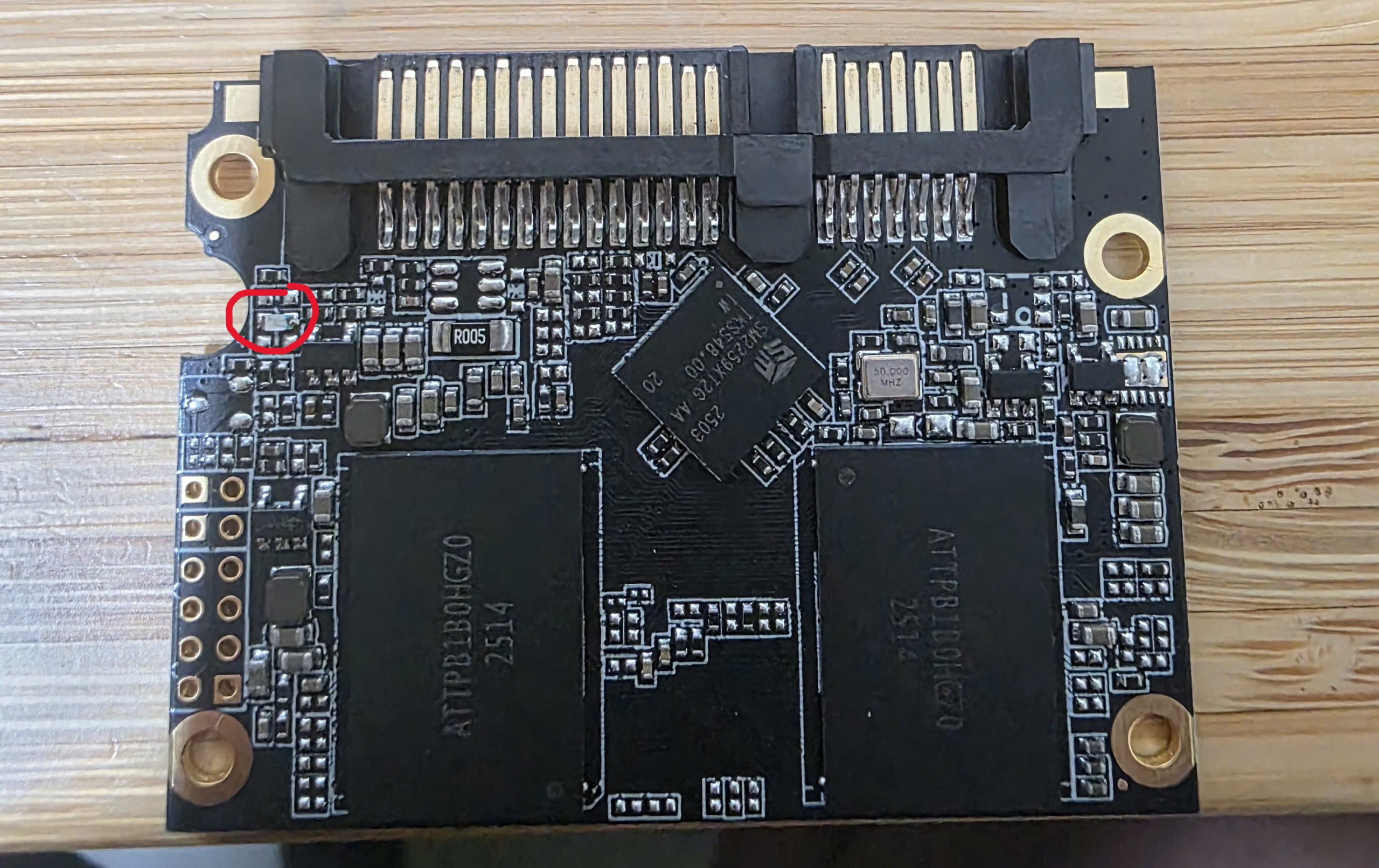

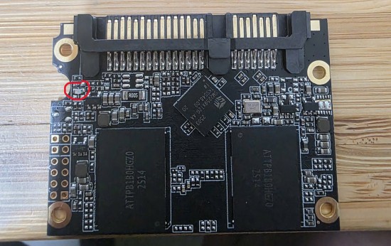

I still have some kind of problem with the SSD
So i have swapped the Donor controller
Now the SSD can enter the ROM mode, and can ID nand fine
However if not in rom mode. The SSD still only have 0.2A The LED on the left doesnt light up? I still think there is some problem with power

 Post subject: Re: Help me find power scheme SSD TeamGroup CX2 SM2259XT2G
PostPosted: Yesterday, 1:27
Posts: 250
Location: Vietnam
I think mine still have something with the power.
The LED on the left doesn't turn on when i turn on the SSD. I tested the LED it is still functional
Any other things that i can test?
PostPosted: Yesterday, 7:16
Posts: 1303
Do you know if that's a power or activity LED - If you have a working donor why no just swap the nand over and get the recovery completed for the client you can work on the why this one does work after.
